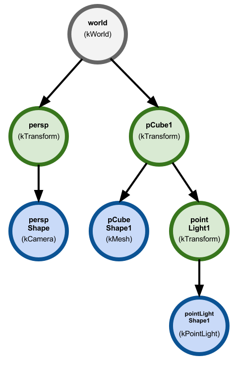

The Directed Acyclic Graph (DAG)
The scene graph in Maya is commonly referred to as the "Directed Acyclic Graph", or DAG. The DAG is actually a subset of a much larger graph, known as the Dependency Graph, which encompasses a much wider variety of node types including shaders, deformers, constraints, etc. For more information, consult the next section, Dependency Graph Plug-in Basics. For now, we will focus our attention DAG nodes, which can be categorized in one of two ways:
  1. Transform Nodes (MFn.kTransform): This node type defines a local 4x4 transformation matrix which affects all the objects beneath it in the hierarchy. This transformation data is manipulated by the MFnTransform function set. Transform nodes can have other transform nodes as their children to group scene elements together.
  2. Shape Nodes (MFn.kMesh, MFn.kCamera, MFn.kLight, ... ): This node type contains the actual geometric information of a scene element, such as the vertices of a mesh. A shape node always has a transform node as its parent.
The diagram below presents the simplified directed acyclic graph (DAG) of a basic scene. The world node represents the scene's root. The green circles correspond to the transform nodes (kTransform), and allow the shapes to be positioned in the scene. The shape nodes are identified by blue circles. In this DAG, perspShape corresponds to a camera in the scene, while pCubeShape1 and pointLightShape1 respectively represent a cubic mesh and a point light in the scene. Observe that the pointLight1 transform node is a child of the pCube1 transform node, which means that if the pCube1 transform node is moved, the point light will be moved as well.
Note: Generally, a shape node cannot have any children under it. The exception to this rule is a special circumstance known as the underworld. The underworld is a DAG subgraph whose root is attached as a child to a shape node. This underworld graph defines the control points and dependencies of a NURBS curve or a NURBS surface.

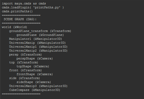

Example Command Plug-in: Printing DAG Paths
Filename: printPaths.py
Sample Script Editor Output:
Program Summary: The plug-in code below creates the printPaths() command. The behavior of this command depends on whether or not the active selection list contains DAG objects. If one or more DAG objects have been selected, their respective names, types, DAG paths and compatible function set types are printed to the Script Editor output. Otherwise, the scene graph is printed using each DAG node's name and type.

# Sample usage.
# Copy the following lines and run them in Maya's Python Script Editor:
import maya.cmds as cmds
cmds.loadPlugin( 'pyPrintPaths.py' )
cmds.pyPrintPaths()

    def printScene(self):
        ''' Traverse and print the elements in the scene graph (DAG)  '''
        # Create a function set which we will re-use throughout our scene graph traversal.
        dagNodeFn = OpenMaya.MFnDagNode()
        # Create an iterator to traverse the scene graph starting at the world node
        # (the scene's origin). We use a depth-first traversal, and we do not filter for
        # any scene elements, as indicated by the 'OpenMaya.MFn.kInvalid' parameter.
        dagIterator = OpenMaya.MItDag( OpenMaya.MItDag.kDepthFirst,
                                       OpenMaya.MFn.kInvalid )
        print '====================='
        print ' SCENE GRAPH (DAG):  '
        # Traverse the scene.
        while( not dagIterator.isDone() ):
            # Obtain the current item.
            dagObject = dagIterator.currentItem()
            depth = dagIterator.depth()
            # Make our MFnDagNode function set operate on the current DAG object.
            dagNodeFn.setObject( dagObject )
            # Extract the DAG object's name.
            name = dagNodeFn.name()
            # Generate our output by first incrementing the tabs based on the depth
            # of the current object. This formats our output nicely.
            output = ''
            for i in range( 0, depth ):
                output += '\t'
            output += name + ' (' + dagObject.apiTypeStr() + ')'
            print output
            # Increment to the next item.
            dagIterator.next()
# Plug-in initialization.
def cmdCreator():
    ''' Creates an instance of our command class. '''
    return OpenMayaMPx.asMPxPtr( printPathsCmd() )
def initializePlugin(mobject):
    ''' Initializes the plug-in.'''
    mplugin = OpenMayaMPx.MFnPlugin( mobject )
    try:
        mplugin.registerCommand( kPluginCmdName, cmdCreator )
    except:
        sys.stderr.write( "Failed to register command: %s\n" % kPluginCmdName )
def uninitializePlugin(mobject):
    ''' Uninitializes the plug-in '''
    try:
        mplugin.deregisterCommand( kPluginCmdName )
    except:
        sys.stderr.write( "Failed to unregister command: %s\n" % kPluginCmdName )
# Sample usage.
cmds.loadPlugin( 'printPaths.py' )
cmds.printPaths()
