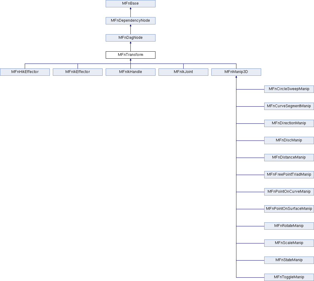

| virtual MFn::Type | type () const |
| | Function set type. More...
| virtual | ~MFnTransform () |
| | Destructor. More...
| MFnTransform () |
| | Default constructor.
| | MFnTransform (MObject &object, MStatus *ReturnStatus=NULL) |
| | Constructor. More...
| | MFnTransform (const MDagPath &object, MStatus *ret=NULL) |
| MObject | create (MObject parent=MObject::kNullObj, MStatus *ReturnStatus=nullptr) |
| | Creates a new transformation node. More...
| MTransformationMatrix | transformation (MStatus *ReturnStatus=nullptr) const |
| | Retrieve the transformation matrix represented by this transform. More...
| MStatus | set (const MTransformationMatrix &transform) |
| | Change this transform to equal the given matrix. More...
| MVector | getTranslation (MSpace::Space space, MStatus *ReturnStatus=nullptr) const |
| | Retrieve the translation component of this transformation in centimeters. More...
| MStatus | setTranslation (const MVector &vec, MSpace::Space space) |
| | Change the translation component of this transformation. More...
| MStatus | translateBy (const MVector &vec, MSpace::Space space) |
| | Relatively change the translation component of this transformation. More...
| MStatus | getScale (double scale[3]) const |
| | Retrieve the scaling component of this transformation. More...
| MStatus | setScale (const double scale[3]) |
| | Set the scaling component of this transformation. More...
| MStatus | scaleBy (const double scale[3]) |
| | Relatively scale this transformation. More...
| MPoint | scalePivot (MSpace::Space space, MStatus *ReturnStatus=nullptr) const |
| | Returns the pivot around which the scale is applied. More...
| MStatus | setScalePivot (const MPoint &point, MSpace::Space space, bool balance) |
| | Set the pivot around which the scale is applied in centimeters. More...
| MVector | scalePivotTranslation (MSpace::Space space, MStatus *ReturnStatus=nullptr) const |
| | Returns the scale pivot translation in centimeters. More...
| MStatus | setScalePivotTranslation (const MVector &vec, MSpace::Space space) |
| | Set the scale pivot translation in centimeters. More...
| MStatus | getShear (double scale[3]) const |
| | Retrieve the shearing component of this transformation. More...
| MStatus | setShear (const double shear[3]) |
| | Set the shearing component of this transformation. More...
| MStatus | shearBy (const double shear[3]) |
| | Relatively shear this transformation. More...
| MStatus | getRotation (MQuaternion &quaternion, MSpace::Space=MSpace::kTransform) const |
| | Retrieve the rotation component of this transformation as a quaternion. More...
| MStatus | setRotation (const MQuaternion &quaternion, MSpace::Space=MSpace::kTransform) |
| | Change the rotation component of this transformation using a quaternion. More...
| MStatus | rotateBy (const MQuaternion &quaternion, MSpace::Space=MSpace::kTransform) |
| | Relatively change the rotation of this transformation using a quaternion. More...
| MStatus | getRotation (MEulerRotation &rotation) const |
| | Retrieve the rotation component of this transformation. More...
| MStatus | setRotation (const MEulerRotation &rotation) |
| | Change the rotation component of this transformation. More...
| MStatus | rotateBy (const MEulerRotation &rotation, MSpace::Space=MSpace::kTransform) |
| | Relatively change the rotation component of this transformation. More...
| MPoint | rotatePivot (MSpace::Space space, MStatus *ReturnStatus=nullptr) const |
| | Returns the pivot about which the rotation is applied. More...
| MStatus | setRotatePivot (const MPoint &point, MSpace::Space space, bool balance) |
| | Set the rotate pivot in centimeters about which rotation is applied. More...
| MVector | rotatePivotTranslation (MSpace::Space space, MStatus *ReturnStatus=nullptr) const |
| | Return the rotate pivot translation in centimeters. More...
| MStatus | setRotatePivotTranslation (const MVector &vec, MSpace::Space space) |
| | Set the rotate pivot translation in centimeters. More...
| MStatus | getRotationQuaternion (double &x, double &y, double &z, double &w, MSpace::Space=MSpace::kTransform) const |
| MStatus | setRotationQuaternion (double x, double y, double z, double w, MSpace::Space=MSpace::kTransform) |
| MStatus | rotateByQuaternion (double x, double y, double z, double w, MSpace::Space=MSpace::kTransform) |
| MStatus | getRotation (double rotation[3], MTransformationMatrix::RotationOrder &order) const |
| MStatus | setRotation (const double rotation[3], MTransformationMatrix::RotationOrder order) |
| MStatus | rotateBy (const double rotation[3], MTransformationMatrix::RotationOrder order, MSpace::Space=MSpace::kTransform) |
| MQuaternion | rotateOrientation (MSpace::Space space, MStatus *ReturnStatus=nullptr) const |
| | Returns the rotation used to orient the local rotation space. More...
| MStatus | setRotateOrientation (const MQuaternion &quat, MSpace::Space space, bool balance) |
| | Set the rotation used to orient the local rotation space. More...
| MTransformationMatrix::RotationOrder | rotationOrder (MStatus *ReturnStatus=nullptr) const |
| | Returns the rotation order for the transform matrix - the order in which the Euler angles are applied to create the end rotation. More...
| MStatus | setRotationOrder (MTransformationMatrix::RotationOrder order, bool reorder) |
| | Change the rotation order for the transform - the order in which the Euler angles are applied to create the end rotation. More...
| MTransformationMatrix | restPosition (MStatus *ReturnStatus) const |
| | Retrieve the saved rest position of this transform. More...
| MStatus | setRestPosition (const MTransformationMatrix &matrix) |
| | Change the saved rest position of this transform. More...
| MStatus | resetFromRestPosition () |
| | Reset the transform to its rest position. More...
| MStatus | clearRestPosition () |
| | Clear the saved rest position of this transform. More...
| bool | isLimited (MFnTransform::LimitType type, MStatus *ReturnStatus=nullptr) const |
| | Determine if the specified limit attribute is enabled or disabled. More...
| double | limitValue (MFnTransform::LimitType type, MStatus *ReturnStatus=nullptr) const |
| | Determine the current value of the specified limit. More...
| MStatus | setLimit (MFnTransform::LimitType type, double value) |
| | Change the limit value for the specified limit type, and automatically enable the limit to be true. More...
| MStatus | enableLimit (MFnTransform::LimitType type, bool flag) |
| | Enable or disable the limit value for the specified limit type. More...
| | MFnTransform (const MObject &object, MStatus *ret=NULL) |
| MStatus | getRotation (double[3], MTransformationMatrix::RotationOrder &order, MSpace::Space space) const |
| | This method is obsolete. More...
| MStatus | setRotation (const double[3], MTransformationMatrix::RotationOrder, MSpace::Space space) |
| MVector | translation (MSpace::Space, MStatus *=nullptr) const |
| virtual | ~MFnDagNode () |
| | Destructor. More...
| | MFnDagNode () |
| | Class Constructor. More...
| | MFnDagNode (MObject &object, MStatus *ret=NULL) |
| | This method is not available in Python. More...
| | MFnDagNode (const MDagPath &object, MStatus *ret=NULL) |
| MObject | create (const MTypeId &typeId, MObject &parent=MObject::kNullObj, MStatus *ReturnStatus=NULL) |
| | Creates a new DAG node with the given type tag. More...
| MObject | create (const MTypeId &typeId, const MString &name, MObject &parent=MObject::kNullObj, MStatus *ReturnStatus=NULL) |
| MObject | create (const MString &type, MObject &parent=MObject::kNullObj, MStatus *ReturnStatus=NULL) |
| MObject | create (const MString &type, const MString &name, MObject &parent=MObject::kNullObj, MStatus *ReturnStatus=NULL) |
| unsigned int | parentCount (MStatus *ReturnStatus=NULL) const |
| | Determines the number of parent Nodes of the Node. More...
| MObject | parent (unsigned int i, MStatus *ReturnStatus=NULL) const |
| | Queries the DAG Node attached to the Function Set for the parent Node corresponding to the given index. More...
| MStatus | addChild (MObject &child, unsigned int index=kNextPos, bool keepExistingParents=false) |
| | Makes the given DAG Node a child of the DAG Node to which this instance of the Function Set is attached. More...
| MStatus | removeChild (MObject &child) |
| | Removes the given DAG Node from the parent. More...
| MStatus | removeChildAt (unsigned int index) |
| | Removes the child at the given index from the parent. More...
| unsigned int | childCount (MStatus *ReturnStatus=NULL) const |
| | Determines the number of child Nodes of the Node. More...
| MObject | child (unsigned int i, MStatus *ReturnStatus=NULL) const |
| | Queries the DAG Node attached to the Function Set for the child Node corresponding to the given index. More...
| MObject | dagRoot (MStatus *ReturnStatus=NULL) |
| | Determines the root of the first DAG Path to the DAG Node attached to the Function Set. More...
| bool | hasParent (const MObject &node, MStatus *ReturnStatus=NULL) const |
| | Determines whether or not the given Node is a parent of the DAG Node attached to the Function Set. More...
| bool | hasChild (const MObject &node, MStatus *ReturnStatus=NULL) const |
| | Determines whether or not the given Node is a child of the DAG Node attached to the Function Set. More...
| bool | isChildOf (const MObject &node, MStatus *ReturnStatus=NULL) const |
| | Determines whether or not the DAG Node attached to the Function Set is a child of the given node. More...
| bool | isParentOf (const MObject &node, MStatus *ReturnStatus=NULL) const |
| | Determines whether or not the DAG Node attached to the Function Set is a parent of the given node. More...
| bool | inUnderWorld (MStatus *ReturnStatus=NULL) const |
| | Determines whether or not the DAG Node is an underworld node. More...
| bool | inModel (MStatus *ReturnStatus=NULL) const |
| | Determines whether or not the DAG Node is in the model. More...
| bool | isInstanceable (MStatus *ReturnStatus=NULL) const |
| | Returns true if the DAG node can be instanced, and false otherwise. More...
| MStatus | setInstanceable (const bool how) |
| | Sets whether or not the DAG node is instanceable. More...
| bool | isInstanced (bool indirect=true, MStatus *ReturnStatus=NULL) const |

Create and access transform nodes.
The MFnTransform function set provides access to transformation DAG nodes called transforms.
DAG nodes are separated into two types, transforms and geometry nodes. All DAG nodes that are not transform nodes must exist as a child of a transform node. Only transforms provide transformation information. Transforms are also commonly used as parent nodes for the purpose of hierarchical grouping.
The transformation in the node is represented as a 4x4 transformation matrix. This function set allows access to the whole matrix, or the individual components (eg scale, rotation, shear, etc) of the transformation. The transform node is made up of many components that make up the final transformation matrix. This breakdown provides animators fine control over the animation of these parameters. Therefore, it is necessary to describe the order in which these attributes are applied to build the final matrix attribute.
A transformation matrix is composed of the following components. All components with units will be in Maya's internal units (radians for rotations and centimeters for translations):
