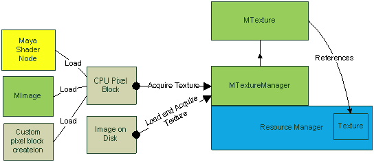

The relationships for texture acquisition are shown in the following diagram:
Figure 28

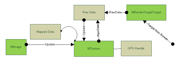

The following diagram illustrates the interaction between the various update possibilities.
Figure 29: On the left, an MImage could be used to upload new context to the MTexture. Part of this data is mapped back to the CPU and the new data copied over. The flow of data shown above the MTexture illustrates possible reading back of the raw data, and the possible updating of the texture using raw data. The top right shows that the raw data can also be read from an offscreen render target. The bottom right illustrates the ability to access the GPU handle in order to update the texture.

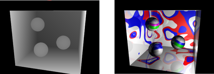

Maya has an internal format for storing depth values relative to a camera either in memory or on disk. This is exposed as part of part of the Maya IFF file format and can be written out by a renderer and / or read from disk via API classes such as MImage.
The following image shows the color and depth from a single .iff file.
Figure 30

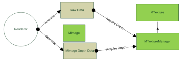

Figure 31: The possible data paths for creating depth textures is shown. The data can be created by a given renderer or by hand. The interfaces to MTextureManager allows for input via raw data or via MImage argument.
