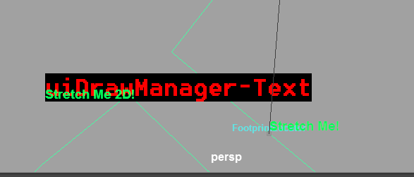

All items are added to the manipulator item list, except for 2D text which will be added to the on top list.
footPrintManip example: The Stretch Me! and Stretch Me 2D! text is drawn on top of the footprint locator (MPxDrawOverride) text (x-ray) and uiDrawManager (MPxDrawOverride ) sample text (transparent UI 2D).

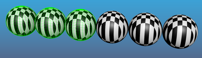

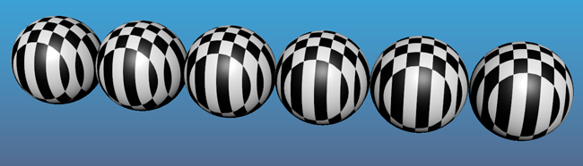

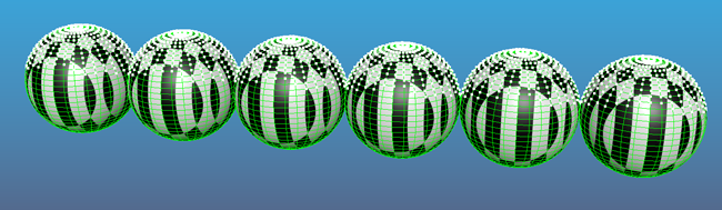

There are 6 transform instances of the same object in this example.
For a single object, there is 1 item added to the opaque list (shaded). This item will also be added to the post-effects list.
Because the subscene override uses hardware instancing; therefore, in total, there is only 1 item added. Each item will use hardware instance drawing with a different world space transform for each instance.

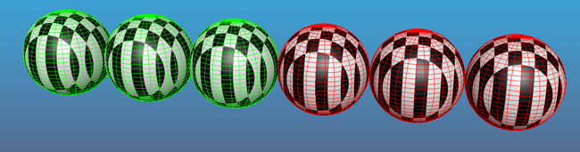

When an instance of an object is selected:
1 wireframe item is added to the opaque UI list.
When vertices are displayed, there is 1 additional item added to the opaque UI list.
Wireframe-on-shaded results in 2 UI items being added: One for dormant and 1 for active wireframe.

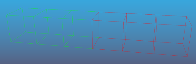

Two items are also added for bounding box. They have a RenderType of MHWRender:: MRenderItem::NonMaterialSceneItem, which means they are not considered as scene items but are still categorized and added to the opaque UI list.
Wireframe, vertices and bounding box items are all added to the non-post effects list.
