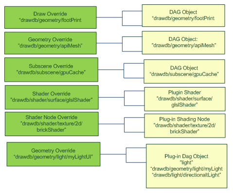

Figure 35: For each override type the classification matches any objects or nodes specified in the classification.

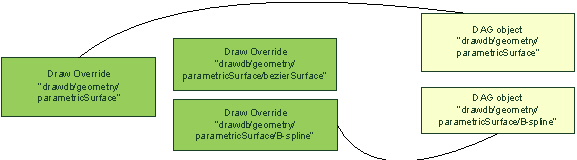

Figure 36: Example demonstrating that, depending on how on how specific the classification is, different matches results. The “drawdb/geometry/parametricSurface/B-spline” DAG object classification matches more closely to the override with the identical classification string, rather than the more generic “drawdb/geometry/parametricSurface” string. The classification with the closest match is used.

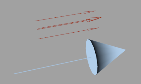

A simple example is given in the apiDirectionalLightShape plug-in example, which draws the following custom geometry (in blue) as compared to the default internal drawing of a directional light.
