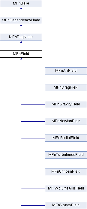

+ Inheritance diagram for MFnField:

Function set for Dynamic Fields.
Function set for creation, edit, and query of Dynamic Fields.
There are several types of dynamic fields: Air, Drag, Gravity, Newton Radial, Turbulence, Uniform, and Vortex.
