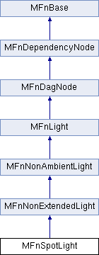

Manage Spot Light dependency Nodes. More...
#include <MFnSpotLight.h>
+ Inheritance diagram for MFnSpotLight:
