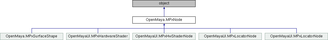

+ Inheritance diagram for OpenMaya.MPxNode:
