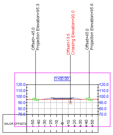

You can visualise the location of objects in relation to section views by adding projections and crossings to the section views.
The following illustration shows projections on either side of the corridor at the existing ground level and one crossing below ground level.
