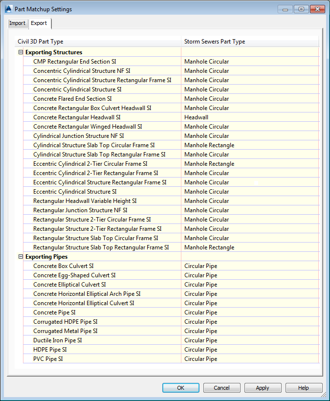

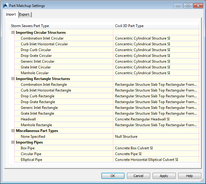

The Part Matching Defaults settings are found in the Feature Settings for Pipe Networks under Storm Sewers Migration Defaults.
Most users find that they get the best results when the Export matchup settings are equivalent to the Import matchup settings. Otherwise, a different Part Family will be substituted upon import.
The Export tab as shown below enables you to select any of the available Storm Sewers Part Types (on the right) to match to each of the Autodesk Civil 3D Part Types found in the current Part Catalogue. The Autodesk Civil 3D Part Types that are shown are updated based on changes made to the Part Catalogue.
The Import tab enables you to select a Autodesk Civil 3D Part Family (on the right) to be used for each available Storm Sewers Part Type. The Storm Sewers Part Type is a fixed list. This mapping should be equivalent to the export mapping so that part families remain the same.
Most new structures in Storm and Sanitary Analysis will export as a rectangular shaped 4 foot by 4 foot structure in the STM file and may not match the same part types that were originally imported as circular structures (if Use Imported Part ID for Part Family is set to No). One possible practice would be to have rectangular Storm Sewers Parts and circular Storm Sewers Parts map to the same Autodesk Civil 3D Part Type, although if the setting are configured with that strategy, a one-to-one mapping between Storm Sewers Part Type and Autodesk Civil 3D Part Type will not be possible.

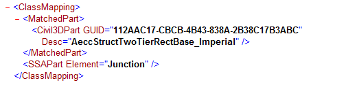

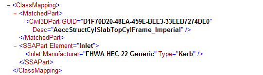

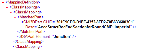

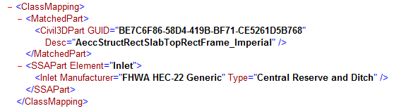

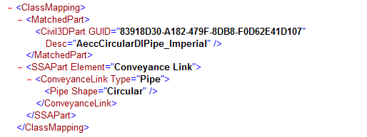

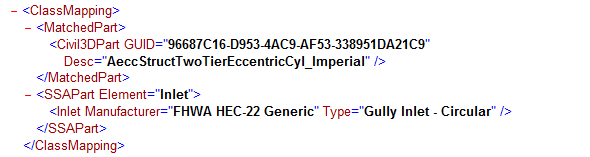

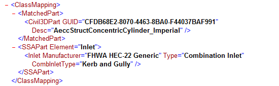

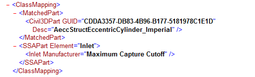

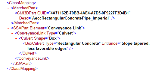

The Autodesk Civil 3D Matched Part portion of the XML file is bounded by a <MatchedPart> begin tab and a </MatchedPart> close tag. For each Autodesk Civil 3D part, or multiple parts, the Autodesk Civil 3D Part ID (part family GUID) and description will be within the matched part construct.
Each Matched Part within a <ClassMapping> element must have a matching singular SSA Part element.
An example of an XML part mapping file is shown below. This example shows the mapping between a custom Autodesk Civil 3D Part Family name "InltKerb1" to a FDOT Kerb Inlet Type 1 found in Storm and Sanitary Analysis.
<ClassMapping>
    <MatchedPart>
      <Civil3DPart GUID = "260FBCAD-7BFC-4DC4-AD9C-84D552C799F5" Desc = "InltCurb1"/>
    </MatchedPart>
    <SSAPart Element = "Inlet">
      <Inlet Manufacturer = "FDOT" PartNumber = "Curb Inlet - Type 1"/>
    </SSAPart>
</ClassMapping>

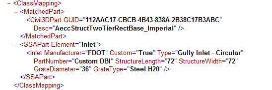

Using the "Custom" Attribute
The matching SSA Part can be as specific or generic as desired. If a fixed Storm and Sanitary Analysis part does not fit your needs, the use of the Custom attribute with a value of "True" enables you to alter some hard coded part values giving you control of specific settings within Storm and Sanitary Analysis.

The XML part mapping file can be edited with Notepad or an XML editor. Only the contents of the ClassMappings tag should be edited. The individual mappings are each contained within the singular ClassMapping tags (see example below).
For each part to be mapped, the schema requires attributes for the Autodesk Civil 3D Part, followed by the Storm and Sanitary Analysis Part.
The Autodesk Civil 3D Part requires the GUID (Part ID), followed by the Description (the description is used to make the file easier to read, but it's not actually used in matching).
The Part ID can be found in the Part Family's XML file which is found in a subfolder of the Part Catalog. The Part Catalogue is set within Autodesk Civil 3D (Home tab Create Design Set Pipe Network Catalogue). The default path for the Part Catalog is: C:\ProgramData\Autodesk\C3D <version>\enu\Pipes Catalog\. For more information, see To Specify the Pipe Network Part Catalog.
Note: A quick way to determine the Part ID is to create the desired pipes and structures in a drawing and export the file to an STM file. The IDs are written to the STM file.
Below is an example showing a Part ID (in bold text) for the Imperial Concentric Cylindrical Structure which is found in the following subfolder and file: …\US Imperial Structures\Junction Structures with Frames\ AeccStructConcentricCylinder_Imperial.xml
<ColumnConst desc="Part ID" dataType="string" unit="" name="PrtID" id="CC5" visible="0" context="Catalog_PartID"index="0">CFDB68E2-8070-4463-8BA0-F44037BAF991</ColumnConst>
The Storm and Sanitary Analysis Part requires the element type, optionally followed by attributes that will vary depending on the element being matched. Be sure to match Autodesk Civil 3D Pipe families to Storm and Sanitary Analysis Link elements and Autodesk Civil 3D Structure families to Storm and Sanitary Analysis Node elements.

The following examples show Autodesk Civil 3D parts that are matched to different types of Storm and Sanitary Analysis parts. The bold items are the attributes that should be edited to make the proper matching. The items in red are the schema tag names and would likely not change for the same element type.
This format could also be used for most of the other elements, except Inlets and Conveyance Links. For example, you could replace "Junction" with the desired element type, such as "Storage", "Outfall", "FlowDiversion", and so on.
Junctions (or other nodes)
Combination Inlet
Kerb Inlet
Gully Inlet
Maximum Capture Cutoff
Central Reserve & Ditch Inlet
Conveyance Link: Pipe
The Conveyance Link Type could include: Pipe, Open Channel, Culvert, or Direct.
The shape will vary depending on the type chosen (refer to available shapes for each type inside Storm and Sanitary Analysis.)
Conveyance Link: Culvert (with culvert type and entrance attributes)
Special Case: Custom Inlets
The Inlet element in Storm and Sanitary Analysis is a special case since there are additional "dimensional" attributes that could be used to map to a more specific cataloged part. More information is available in the SSA_Mapping_Definition.docx file mentioned above. Be sure to use the appropriate attributes for the specific part in Storm and Sanitary Analysis that you are mapping to.
Example: (this example maps to a custom FDOT circular gully with custom attributes)

  2. Open the Pipe Network Feature Settings dialog box and examine the Part Matchup Settings. On the Export tab:
    • The Concrete pipe is mapped to Circular Pipe
    • The HDPE pipe is mapped to Circular Pipe
    This means that both pipe types will be exported to the Circular Pipe type.
  3. On the Import tab, under Importing Pipes, Circular Pipes can only match to one type, "Concrete Pipe."
    This means that by default, circular pipes that are not concrete, such as the Corrugated HDPE pipe, will be switched to Concrete on import. The following example shows how to set up the XML part mapping file so the pipe type is retained on import.
