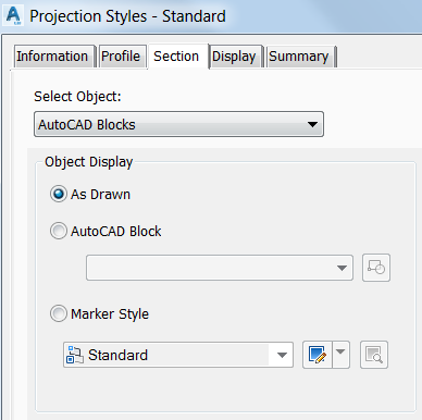

Projected objects in section views use the following styles:
Multipurpose Styles
Projection Styles collection on the Settings tab in Toolspace. Use the Section tab to configure the display settings for section view.
Label Styles
Projection collection on the Settings tab in Toolspace.

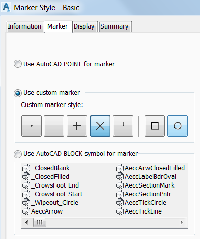

Crossing objects in section views use the following styles:
Multipurpose Styles
Marker Styles collection on the Settings tab in Toolspace.

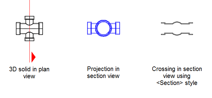

Marker styles can be set up to use AutoCAD points, custom marker symbols blocks.
3D solids can also use <Section> as the crossing marker style. By selecting the <Section> style, the solid is drawn so that it represents the actual position of where the sample line crosses the solid.
