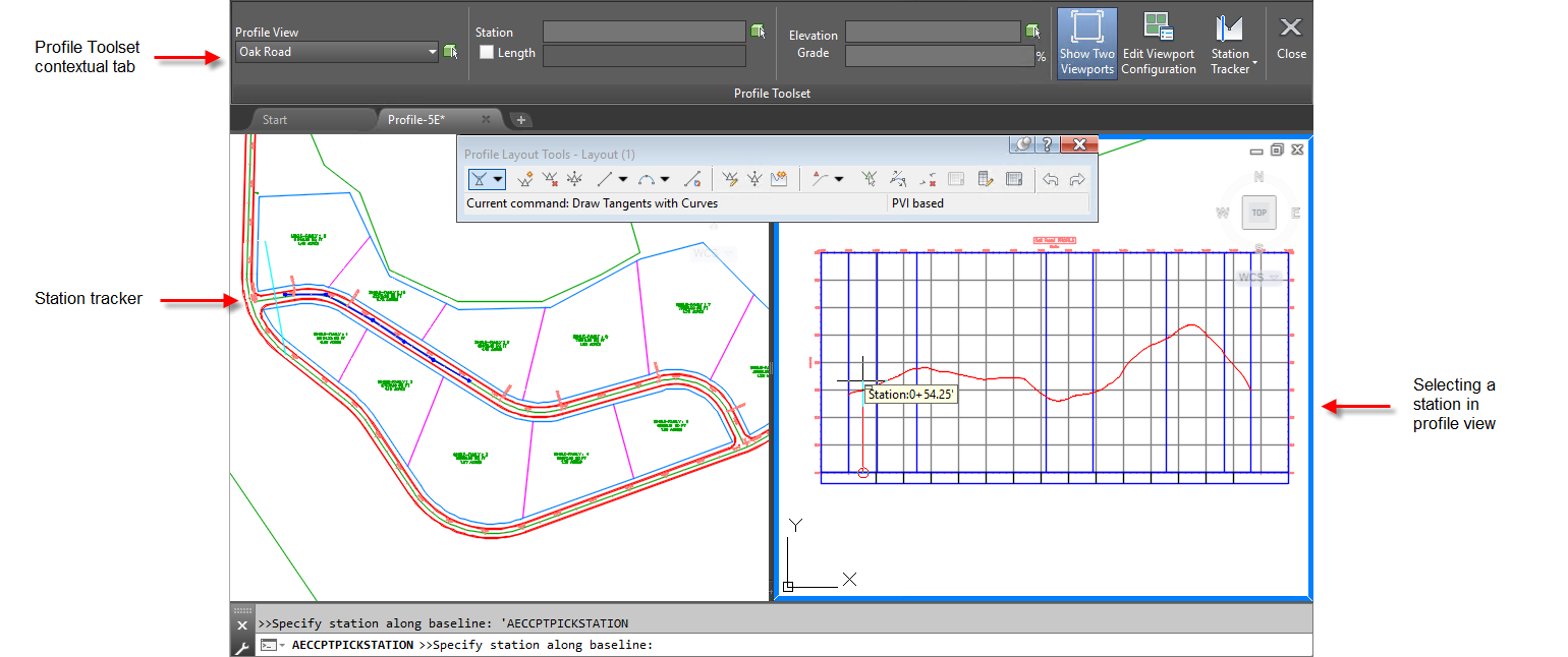

The following illustration shows the Profile Toolset contextual tab as it was invoked while creating a layout profile. When you click the Profile Toolset button on the Transparent Commands ribbon, the Profile Toolset tab is displayed and the drawing viewports are configured to display a plan view and a profile view.
You're first prompted to specify a chainage. You can select a chainage by clicking in either plan view or profile view. You can also enter or change the chainage value in the Chainage field on the ribbon.
After you specify the chainage, you're prompted for a level. You can move your cursor and click to specify the level.
After you specify the first point using a chainage and level, you can then use the other options on the Profile Toolset tab like Length and Gradient to continue to draw profile entities.
Profile Toolset Contextual Ribbon Tab
When you click the Profile Toolset button on the Transparent Commands ribbon, the Profile Toolset tab is displayed.

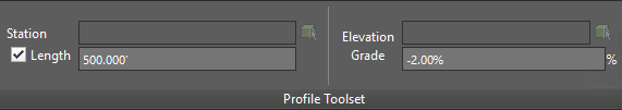

- Length check box: When selected, enables the Length field.
Note: When you select the Length check box, you can specify a length in the Length field and you can also specify a gradient in the Gradient field. The Chainage and Level fields become unavailable.
- Length: Specifies the length to use. Use along with a specified gradient to create a VIP at a specified length and gradient.

- Gradient: Specifies the gradient to use. Use along with a specified length.
