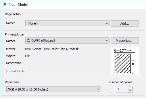

Page Setup in Drawings Created from Drawing Template (DWT) Files
    Selecting a page setup in Autodesk Civil 3D 2019
  • When they are opened in Autodesk Civil 3D 2019, drawings that were created using DWT files from AutoCAD Civil 3D 2017 and AutoCAD Civil 3D 2018 may default to showing the <None> page setup in the Plot dialog box and don't retain the name of a new selection (they return to the <None> selection) if you select a different page setup from the list.
    To resolve this issue, the page setup definitions that you want to use need to be resaved in Autodesk Civil 3D 2019.
    1. Click Output tab Plot panel Page Setup Manager to display the Page Setup Manager dialog box.
    2. Select the page setup you want to use.
    3. Click Modify to display the Page Setup dialog box and then click OK.
    4. Repeat this process for each page setup you want to use.
      After resaving a page setup, when you open the Plot dialog box and select the page setup, the selection is retained.
