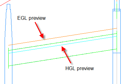

Graphical View in Profile
Use these settings to control the color of the temporary graphics used in profile view to preview the analysis results.
The following illustration shows a detail of the EGL and HGL lines in the preview.
Hydraulic Gradient Line
Specifies the color to use in profile view to indicate the HGL.
Energy Gradient Line
Specifies the color to use in profile view to indicate the EGL.
New Pipe Size
Specifies the color to use in profile view to indicate the updated pipe size.
