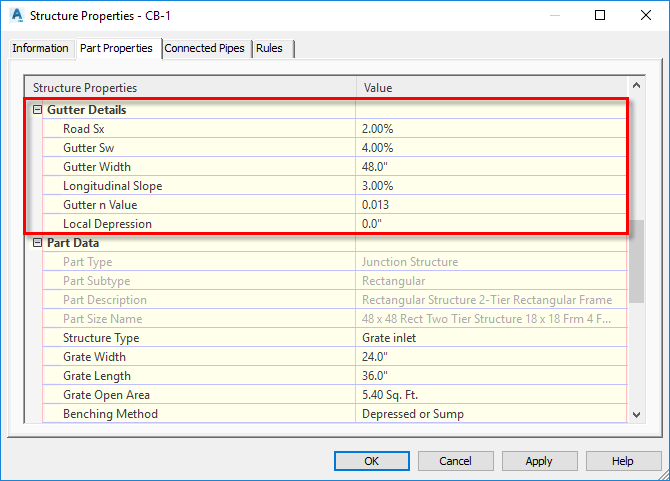

Specifying Default Settings
Settings that must be specified manually for the tributary areas and pipes, or which are used as values in the analysis calculations, can be pre-established as defaults on the Settings page. Click the Settings button on the General page to open this dialog box.
Default settings for structures can be specified in the Edit Feature Settings – Structure dialog box.

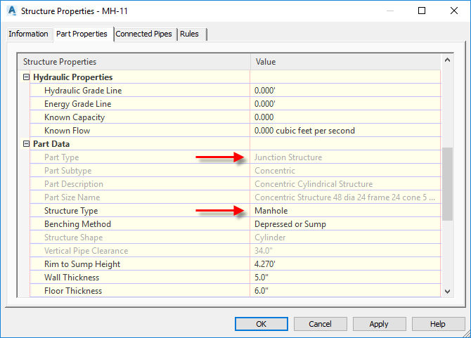

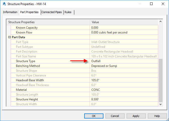

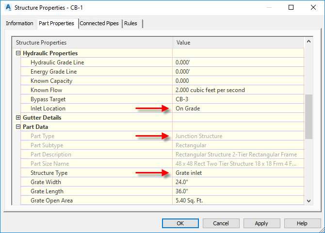

Parameter Mapping for Parts Created with Part Builder
You can map the parameters of parts created with Part Builder to parameters that are required for the Analyse Gravity Network command.
By mapping the parameters and applying them to the structures in existing pipe networks, you will not need to manually specify the values when you are using the Analyse Gravity Network command.
For more information, see To Map Drainage Structure Parameters for Gravity Network Analysis.
Note: Parts created with the Infrastructure Parts Editor already have the parameters that are required for the Analyse Gravity Network command and do not require mapping.

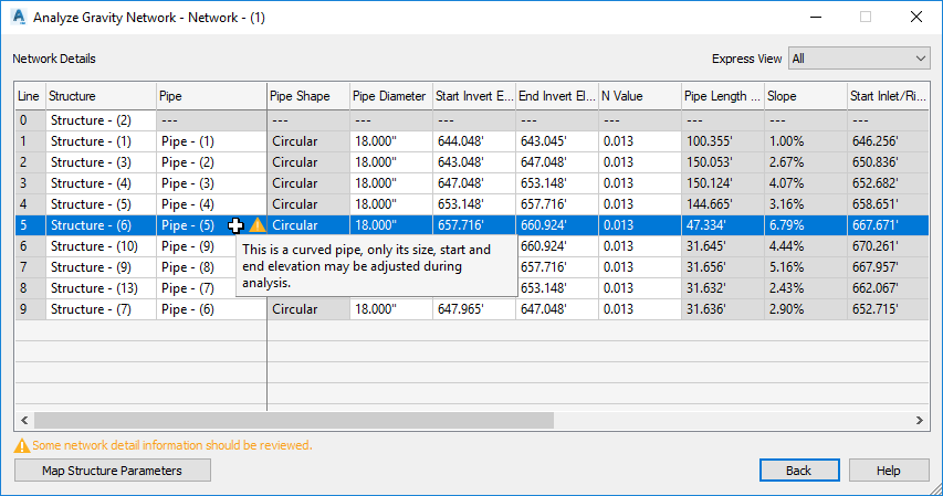

Network Details Information
Use the Network Details page of the Analyse Gravity Network dialog box to review and change the network detail information that is relevant to the selected analysis types.
If the analysis type you select cannot be performed, an error message is displayed below the Network Details button on the General page of the Analyse Gravity Network dialog box.
If some of the network detail information should be reviewed, a warning message is displayed below the Network Details button on the General page.
Click the Network Details button to open the Network Details page where you can review errors and warnings and change the network detail settings.
For more information, see Network Details Page (Analyse Gravity Network Dialog Box).
