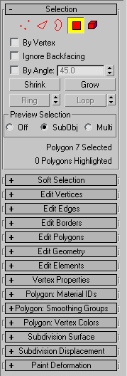

<Editable_Poly>.selByVertex Boolean default: false -- boolean; Select_By_Vertex
Get/Set the By Vertex checkbox in the Selection rollout.
<Editable_Poly>.ignoreBackfacing Boolean default: false -- boolean; Ignore_Backfacing_in_Selections
Get/Set the state of the Ignore Backfacing checkbox in the Selection rollout.
<Editable_Poly>.selectByAngle BooleanClass default: false -- boolean; Select_by_Angle
Get/set the state of the By Angle checkbox.
<Editable_Poly>.selectAngle Float default: 45.0 -- angle; Selection_Angle
Get/Set the By Angle value.
<Editable_Poly>.ringEdgeSel Integer default: 0 -- integer; Ring_Sel
Get/Set the Edge Ring value.
Available in 3ds Max 8 and higher.
<Editable_Poly>.loopEdgeSel Integer default: 0 -- integer; Loop_Sel
Get/Set the Edge Loop value.
<Editable_Poly>.selectMode Integer default: 0 -- integer; Select_Mode
Get/Set the Preview Selection Mode in 3ds Max 2008 and higher.
Possible values are:
0 - Off
1 - SubObj
2 - Multi

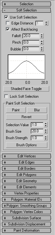

<Editable_Poly>.useSoftSel Boolean default: false -- boolean; Use_Soft_Selection
Get/Set the state of the "Use Soft Selection" checkbox in the Soft Selection rollout.
<Editable_Poly>.ssUseEdgeDist Boolean default: false -- boolean; Use_Edge_Distance
Get/Set the state of the Edge Distance checkbox in the Soft Selection rollout.
<Editable_Poly>.ssEdgeDist Integer default: 1 -- integer; Edge_Distance
Get/Set the Edge Distance value in the Soft Selection rollout
<Editable_Poly>.affectBackfacing Boolean default: true -- boolean; Affect_Backfacing
Get/Set thestate of the Affect Backfacing checkbox in the Soft Selection rollout.
<Editable_Poly>.falloff Float default: 20.0 -- animatable; world units
Get/Set the Falloff value in the Soft Selection rollout.
<Editable_Poly>.pinch Float default: 0.0 -- animatable; world units
Get/Set the Pinch value in the Soft Selection rollout.
<Editable_Poly>.bubble Float default: 0.0 -- animatable; world units
Get/Set the Bubble value in the Soft Selection rollout.
<Editable_Poly>.lockSoftSel BooleanClass default: false -- boolean; Lock_Soft_Selection
Get/Set the state of the Lock Soft Selection checkbox.
When locked, the soft selection will not be recalculated dynamically based on the existing "hard" selection and will allow for custom soft selection values to be painted using a brush.
<Editable_Poly>.paintSelSize Float default: 10.0 -- world units; Brush_Size
Get/Set the Size of the Soft Selection brush.
<Editable_Poly>.paintSelStrength Float default: 1.0 -- float; Brush_Strength
Get/Set the Strength of the Soft Selection brush.
<Editable_Poly>.paintSelValue Float default: 1.0 -- float; Selection_Value
Get/Set the Soft Selection Value to be painted with.

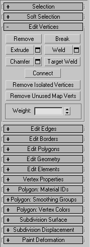

<Editable_Poly>.vertexBreak Float default: 0.0 -- worldUnits; Vertex_Break
Get/Set the Vertex Break value.
For methods related to breaking vertices, see
EditablePoly Methods - Break / Divide / Split
EditablePoly Interface - Break / Split / Divide
EditablePoly Interface - UI Commands - buttonOp #BreakVertex method
<Editable_Poly>.vertexChamfer Float default: 1.0 -- world units; Vertex_Chamfer_Amount
Get/Set the Vertex Chamfer Amount value.
<Editable_Poly>.vertexChamferOpen BooleanClass default: false -- boolean; Open_Chamfer
Get/Set the state of the "Open" checkbox in the Vertex Chamfer options dialog.
When set to True, the new polygons created by the Chamfer operation will be removed, leaving an opening.
<Editable_Poly>.vertexExtrudeHeight Float default: 10.0 -- world units; Vertex_Extrude_Height
Get/Set the Vertex Extrusion Height value
<Editable_Poly>.vertexExtrudeWidth Float default: 3.0 -- float; Vertex_Extrude_Width
Get/Set the vertex extrusion Base Width value
For methods related to extruding and chamfering vertices, see
EditablePoly Interface - Chamfer
EditablePoly Interface - UI Commands - buttonOp #Chamfer method

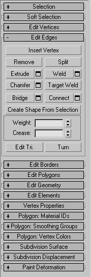

<Editable_Poly>.edgeChamferType Integer default: 0 -- integer; Chamfer_Type
Get/set the Chamfer type.
0 - Legacy Chamfer Mode (default)
1 - Quad Chamfer
Available in 3ds Max 2015 and higher.
<Editable_Poly>.edgeChamfer Float default: 1.0 -- world units; Edge_Chamfer
Get/Set the Edge Chamfer Amount value.
<Editable_Poly>.edgeChamferOpen BooleanClass default: false -- boolean; Open_Chamfer
Get/Set the state of the Open checkbox in the Edge Chamfer options dialog.
<Editable_Poly>.edgeChamferInvert BooleanClass default: false -- boolean; Invert_Open
Get/set the state of the Invert Open checkbox in the Chamfer options dialog.
When set to True, the chamfered polygons will be retained and the original polygons will be removed.
<Editable_Poly>.edgeChamferSmooth BooleanClass default: true -- boolean; Smooth
Get/set the state of the Smooth checkbox in the Chamfer options dialog.
<Editable_Poly>.edgeChamferSmoothType Integer default: 0 -- integer; Smooth_Type
Get/set the selection of the Smooth Type option in the Chamfer options dialog.
0 - Smooth Entire Object
1 - Smooth Chamfers Only
<Editable_Poly>.edgeChamferSmoothThreshold Float default: 30.0 -- float; Smooth_Threshold
Get/set the value of the "Smooth Threshold" checkbox in the Chamfer options dialog.
<Editable_Poly>.edgeChamferTension Float default: 1.0 -- float; Edge_Tension
Get/set the Tension value for the Chamfer mode.

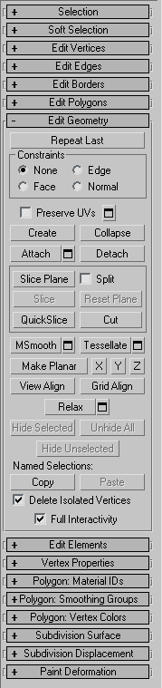

<Editable_Poly>.edgeExtrudeHeight Float default: 10.0 -- world units; Edge_Extrude_Height
Get/Set the Edge Extrusion Height value.
<Editable_Poly>.edgeExtrudeWidth Float default: 3.0 -- float; Edge_Extrude_Width
Get/Set the edge extrusion Base Width value
<Editable_Poly>.edgeWeldThreshold Float default: 0.1 -- world units; Edge_Weld_Threshold
Get/Set the Edge Weld Threshold value
<Editable_Poly>.edgeChamferSegments Integer default: 1 -- integer; Edge_Chamfer_Segments
Get/Set the Edge Chamfer Segments amount.
Adding Segments to the Edge Chamfer effectively performs an Edge Fillet, rounding the edge.
Available in 3ds Max 2008 and higher.
For related methods, see
polyOp Methods - Extrude/Bevel/Chamfer
<Editable_Poly>.edgeChamferQuadIntersections BooleanClass default: false -- boolean; alias: quad_intersections
Get/Set the Edge Chamfer Quad Intersections mode. Available in 3ds Max 2018 and higher.

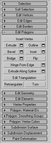

<Editable_Poly>.bevelHeight Float default: 10.0 -- world units; Bevel_Height
Get/Set the Bevel Extrusion Height value
<Editable_Poly>.bevelOutline Float default: -1.0 -- world units; Bevel_Outline
Get/Set the Bevel Outline value.
<Editable_Poly>.bevelType Integer default: 0 -- integer; Type_of_Bevel
Get/Set the Extrusion Type in the Bevel dialog
0 - Group
1 - Local Normal
2 - by Polygon
EditablePoly Interface - Bevel
EditablePoly Interface - UI Commands - buttonOp #Bevel method

<Editable_Poly>.insetAmount Float default: 1.0 -- world units; Inset_amount
Get/Set the Inset Amount value.
<Editable_Poly>.insetType Integer default: 0 -- integer; Inset_Type
Get/Set the Inset Type:
0 - Group
1 - By Polygon
EditablePoly Interface - UI Commands - buttonOp #Inset method

For methods related to creating vertices, edges and faces, see
EditablePoly Interface - Create
No related properties exposed.
For methods related to collapsing vertices, edges and faces, see
EditablePoly Interface - Collapse
For methods related to attaching and detaching geometry, see
EditablePoly Interface - Attach/Detach
<Editable_Poly>.split Boolean default: false -- boolean
Get/Set the state of Split checkbox.
<Editable_Poly>.cutEndCoords Point3 default: [0,0,0] -- point3; Cut_End_Coordinates
Get/Set the Cut End Coordinates.
<Editable_Poly>.cutNormal Point3 default: [0,0,0] -- point3; Cut_Normal_Direction
Get/Set the Cut Normal Vector.
<Editable_Poly>.cutStartCoords Point3 default: [0,0,0] -- point3; Cut_Start_Coordinates
Get/Set the Cut Start Coordinates.
<Editable_Poly>.cutStartIndex Integer default: 1 -- index; Cut_Start_Index
Get/Set the index of the Cut Start Vertex.
<Editable_Poly>.cutStartLevel Integer default: 1 -- integer; Cut_Start_SO_Level
Get/Set the Cut Start Sub-Object Level.
For methods related to slicing geometry, see
EditablePoly Interface - Slice
EditablePoly Interface - SlicePlane
<Editable_Poly>.smoothness Float default: 1.0 -- float
Get/Set the Viewport Smoothness value in the Subdivision Surface rollout.
<Editable_Poly>.separateByMaterial Boolean default: false -- boolean; Separate_by_Material_ID
Get/Set the Separate By Materials checkbox in the Edit Geometry rollout > MSmooth option > MeshSmooth Selection dialog.
<Editable_Poly>.separateBySmoothing Boolean default: false -- boolean; Separate_by_Smoothing_Groups
Get/Set the Separate By Smoothing checkbox in the Edit Geometry rollout > MSmooth option > MeshSmooth Selection dialog.
For related methods see
EditablePoly Interface - Subdivide
<Editable_Poly>.tesselateBy Integer default: 0 -- integer; Tessellate_By
Get/Set the Tessellation type.
0 - Edge
1 - Face
<Editable_Poly>.tessTension Float default: 0.0 -- float; Tessellation_Tension
Get/Set the Tessellation Tension.
For methods related to making geometry planar, see
<Editable_Poly>.relaxAmount Float default: 0.5 -- animatable; float; Relax_Amount
Get/Set the Relax Amount value.
<Editable_Poly>.relaxHoldBoundaryPoints BooleanClass default: true -- boolean; Relax_Hold_Boundary_Points
Enable/Disable the "Hold Boundary Points" option.
<Editable_Poly>.relaxHoldOuterPoints BooleanClass default: false -- boolean; Relax_Hold_Outer_Points
Enable/Disable the "Hold Outer Points" option.
<Editable_Poly>.relaxIterations Integer default: 1 -- animatable; integer; Relax_Iterations
Get/Set the number of Relax Iterations.
EditablePoly Interface - Relax

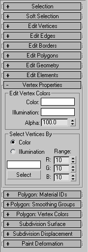

<Editable_Poly>.vertSelectBy Integer default: 0 -- integer; Select_Vertex_By
Get/Set the state of the Select Vertices By radio buttons.
0 - Color
1 - Illumination
<Editable_Poly>.vertSelectionRedRange Integer default: 10 -- integer; Select_by_color__Red_Range
Get/Set the Red color value of the Range in the Vertex Properties rollout.
<Editable_Poly>.vertSelectionGreenRange Integer default: 10 -- integer; Select_by_color__Green_Range
Get/Set the Green color value of the Range in the Vertex Properties rollout.
<Editable_Poly>.vertSelectionBlueRange Integer default: 10 -- integer; Select_by_color__Blue_Range
Get/Set the Blue color value of the Range in the Vertex Properties rollout.

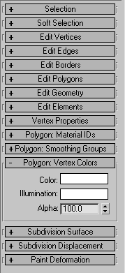

<Editable_Poly>.vertSelectionColor Color default: (color 255 255 255) -- RGB color; Vertex_Selection_Color
Get/Set the color value of the Range in the Vertex Properties rollout.

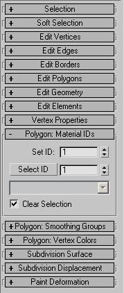

For methods related to setting the Face Material ID, see
For methods related to selecting Faces by Material ID, see
EditablePoly Interface - UI Commands - buttonOp #SelectByMaterialID method

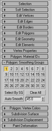

<Editable_Poly>.SmGrpFloater ()
Toggles the visibility of a Smoothing Groups floater version of this rollout.
Available in 3ds Max 2010 and higher.
<bool><Editable_Poly>.SmGrpFloaterVisible ()
Returns True if the Smoothing Groups floater is visible, False if it is hidden.
<Editable_Poly>.autoSmoothThreshold Float default: 45.0 -- angle; Autosmooth_angle_threshold
Get/Set the Autosmooth Threshold value in the Polygon Properties rollout > Smoothing Groups group.

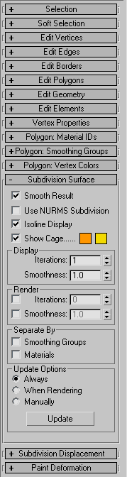

<Editable_Poly>.subdivSmoothing Boolean default: true -- boolean; Smooth_Subdivision_Result
Get/Set the state of the Smooth Result checkbox in the Subdivision Surface rollout.
<Editable_Poly>.surfSubdivide Boolean default: false -- boolean; Subdivide_Surface
Get/Set the state of the Use NURMS Subdivisions checkbox in the Subdivision Surface rollout.
<Editable_Poly>.isolineDisplay Boolean default: true ; Isoline_Display
Get/Set the Isoline Display state.
<Editable_Poly>.showCage Boolean default: true -- boolean; Show_Cage
Get/Set the state of the Show Cage checkbox in the Subdivision Surface rollout.
<Editable_Poly>.CageColor Point3 default: [1,0.588235,0] -- point3; Cage_Color
Get/Set the Cage color.
<Editable_Poly>.selectedCageColor Point3 default: [0.94902,0.85098,0] -- point3; Selected_Cage_Color
Get/Set the Selected Cage color.
<Editable_Poly>.iterations Integer default: 0 -- animatable; integer
Get/Set the Subdivision Surface rollout > Display group > Iterations value.
<Editable_Poly>.surfaceSmoothness Float default: 1.0 -- animatable; float; Surface_Smoothness
Get/set the Subdivision Surface rollout > Display group > Smoothness value.
<Editable_Poly>.useRenderIterations Boolean default: false -- boolean; Use_Render_Iterations
Get/Set the state of the Render Iterations checkbox in the Subdivision Surface rollout.
<Editable_Poly>.renderIterations Integer default: 0 -- animatable; integer; Render_Iterations
Get/Set the Subdivision Surface Render Iterations value.
<Editable_Poly>.useRenderSmoothness Boolean default: false -- boolean; Use_Render_Smoothness
Get/Set the state of the Render Smoothness checkbox in the Subdivision Surface rollout.
<Editable_Poly>.renderSmoothness Float default: 1.0 -- animatable; float; Render_Smoothness
Get/Set the Subdivision Surface rollout > Render group > Smoothness value.
<Editable_Poly>.sepByMats Boolean default: false -- boolean; Separate_by_Material_ID
Get/Set the Separate By Materials checkbox in the Subdivision Surface rollout.
<Editable_Poly>.sepBySmGroups Boolean default: false -- boolean; Separate_by_Smoothing_Groups
Get/Set the Separate By Smoothing checkbox in the Subdivision Surface rollout.

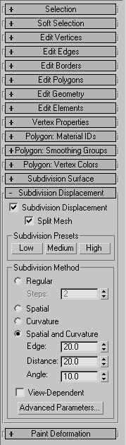

<Editable_Poly>.displaceSplitMesh Boolean default: true -- boolean; Displacement_Split_Mesh
Get/Set the state of the Split Mesh checkbox in the Subdivision Displacement rollout.
<Editable_Poly>.displaceSteps Integer default: 2 -- animatable; integer; Displacement_Steps
Get/Set the Displace Steps value
<Editable_Poly>.displaceStyle Integer default: 1 -- integer; Displacement_Style
Get/Set the Displacement Style under Subdivision Displacement > Advanced Parameters
0 - Grid
1 - Tree
2 - Delaunay
<Editable_Poly>.useSubdivisionDisplacement Boolean default: false -- boolean; Use_Displacement_Subdivision
Get/Set the state of the "Subdivision Displacement" checkbox in the Subdivision Displacement rollout.
<Editable_Poly>.viewDependent Boolean default: false -- boolean; View_Dependent
Get/Set the state of the View Dependent checkbox in the Subdivision Displacement rollout.

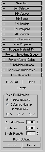

<Editable_Poly>.paintDeformAxis Integerdefault:1--integer;Push_Pull_Direction
Get/Set the state of the Push/Pull Direction radio buttons in the Paint Deformation rollout.
1 - Original Normals
2 - Deformed Normals
3 - Transform Axis : X
4 - Transform Axis : Y
5 - Transform Axis : Z
<Editable_Poly>.paintDeformSize Float default: 20.0 -- world units; Deformation_Size
Get/Set the Size of the Paint Deform brush.
<Editable_Poly>.paintDeformStrength Float default: 1.0 -- float; Deformation_Strength
Get/Set the Strength of the Paint Deform brush.
<Editable_Poly>.paintDeformValue Float default: 10.0 -- float; Deformation_Value
Get/Set the Value to be painted with.
