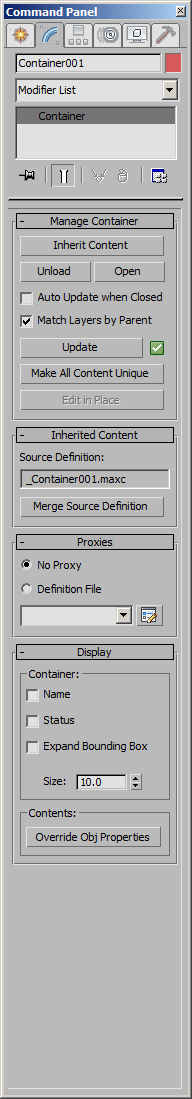

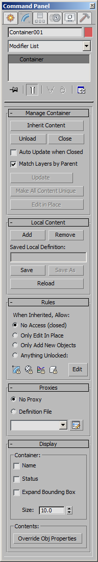

The content rules are stored with the .MAXC asset file and control how the content will behave when inherited by a container.
<Container>.allowInPlaceEditing BooleanClass default: false -- boolean; Allow_In_Place_Editing
Get/set the In Place Editing Container Rule.
Corresponds to the state of the "Allow In-Place Editing" checkbox in the Container's UI.
When set to false (default), the content can be inherited, but not edited in place.
When set to true , the content can be inherited and edited in place, resulting in overwriting of the content in the original asset file.
<Container>.accessContent BooleanClass default: false -- boolean; Allow_Content_Access
Get/set the state of the Access Content Rule.
This Rule is not exposed to the User Interface and is considered only when .AllowInPlaceEditing is set to false . When In Place Editing is allowed, the content of a closed container will not be accessible regardless of this Rule.
When set to false (default), the content will not be accessible when inherited. The content cannot be selected, modified or accessed using MAXScript.
When set to true , the content will be accessible when inherited. Any local modification to such content will be LOST when Unloaded.
<Container>.accessPublishedContent BooleanClass default: false -- boolean; Allow_Published_Content_Access
Get/set the state of the Access Published Content Rule.
This Rule is not exposed to the User Interface.

<Container>.editingUser String default: "" -- string; Editing_User;
Get/set the name of the user editing the Container.
Available in 3ds Max 2011 and higher.
<Container>.contentBoundingBox BooleanClass default: false -- boolean; Content_Bounding_Box
Get/set the state of the Expand Bounding Box checkbox.
When set to true , a bounding box of the container will expand to enclose the content.
<Container>.size Float default: 10.0 -- animatable; worldUnits
Get/set the Size value controlling the size of the Container's icon.
<Container>.updateNeeded BooleanClass default: false -- boolean; Update_Needed
Contains true if the Container needs an update. Reflects the state of the icon next to the Update button.
Read-only.
<Container>.overrideNodeProperties BooleanClass default: false -- boolean; Override_Object_Properties
Get/set the state of the "Override Obj Properties" checkbutton.
When set to true , the content will display using the Container's display properties including wireframe color, visibility settings, and so on. If the content is set to use properties By Layer, the Container's Layer will be used instead of the content's Layers.
When set to false , the content will display using its own display properties.
