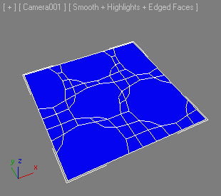

<bool>PolyToolsTopology.Skin ()
Generates a skin type topology with rounded patches.
Returns true on success, false on failure.
EXAMPLE:
--Step 1:
p = Plane widthsegs:10 lengthsegs:10 wirecolor:blue --create a plane
convertTo p Editable_Poly --convert to EPoly
select p --select the plane
max modify mode --switch to modify panel
subObjectLevel = 4 --switch to Edge level
--Step 2:
PolyToolsTopology.Skin()

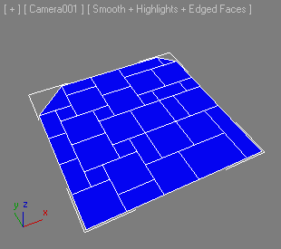

When applied to a grid of quads, generates topology similar to the .Planks1() and .Planks2() methods, but with crossing planks.
EXAMPLE:
--Step 1:
--Step 2:
PolyToolsTopology.Planks3()

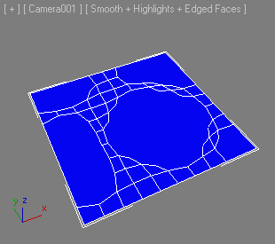

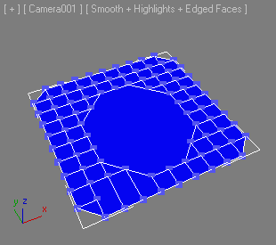

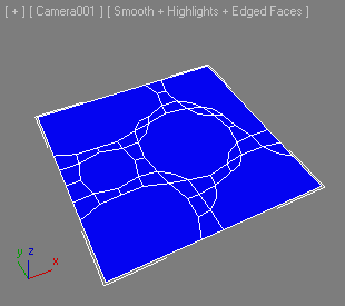

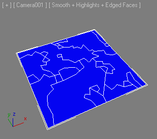

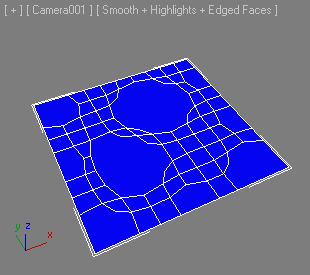

<bool>PolyToolsTopology.Tatter <integer>size <integer>iterations <integer>smooth
Generates "holes" in the topology, separated by rows of polygons.
The first argument determines the overall size of the generated holes.
The second argument determines the number of different sizes for the generated holes.
The third argument determines how rounded the generated holes will be.
EXAMPLES:
--Step 1:
--Step 2:
PolyToolsTopology.Tatter 1 1 1
--Step 1:
--Step 2:
PolyToolsTopology.Tatter 2 1 1
-- Step 1:
--Step 2:
PolyToolsTopology.Tatter 3 1 1
--Step 1:
--Step 2:
PolyToolsTopology.Tatter 1 2 1
--Step 1:
--Step 2:
PolyToolsTopology.Tatter 1 10 1
