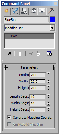

The following lines prepare our box for more complex transformations. They change the number of box segments on all sides, and put a check mark into the Generate Mapping Coords. box in the Parameters rollout:
ENTER THE FOLLOWING FOUR LINES OF CODE: |
mybox.lengthsegs = 10 mybox.widthsegs = 10 mybox.heightsegs = 10 mybox.mapCoords = true |
MAXScript has changed the appropriate settings in the Parameters rollout:

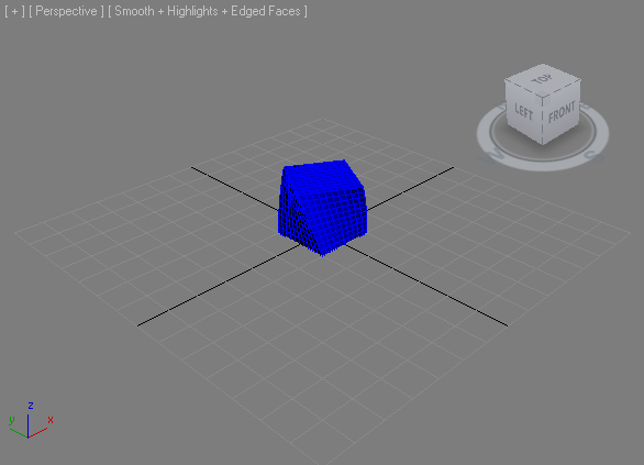

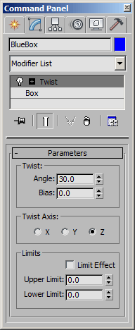

To create a Twist modifier set to 30 degrees and apply it to your box,
ENTER |
addModifier mybox (twist angle:30) |
The box in your Perspective viewport is now twisted and the interface shows the new Twist modifier in the modifier stack display, together with its parameters:

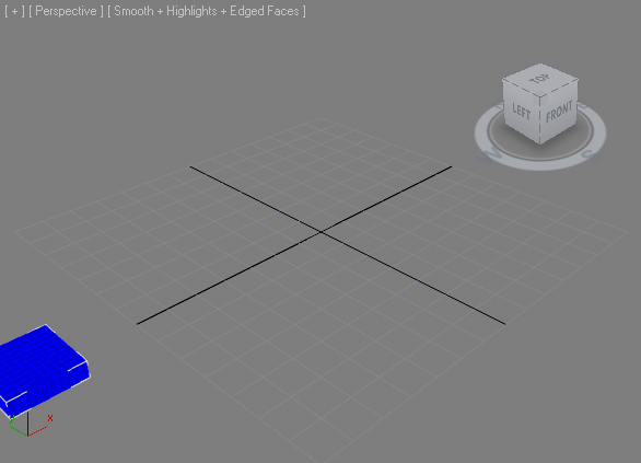

MAXScript has several syntax forms that mirror the main UI tools such as, the Auto Key button, the time slider, and the active coordinate system.
In the following example, you turn on the Auto Key button, set the slider to several different values, and adjust the properties of your box, just as you would do using the software’s UI:
EXAMPLE: |
animate on ( at time 0 (mybox.pos = [-100, 0, 0]; mybox.scale = [1, 1, 0.25]) at time 100 (mybox.pos = [100, 0, 0]; mybox.scale = [1, 1, 3]) ) |
Drag the slider around, and you will see that MAXScript has animated the box, and placed keyframes at 0 and 100.
When you use MAXScript to animate objects, the actual Auto Key button in the UI does not come on, nor does the time slider move; these things happen within MAXScript.
