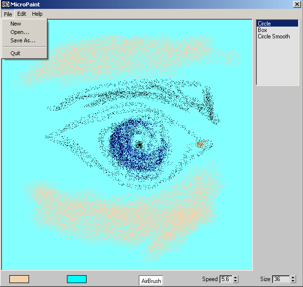

In this step of the Bitmap Painting tool development, we will add a main menu bar with New, Open, and Save options.
NATURAL LANGUAGE |
We will define a new right-click menu with some menu items and corresponding event handlers. |
We will assign the right-click menu as menu bar to the dialog. |

We will define a second bitmap called background. It will not be used now, but will be needed in the next tutorial to allow for an eraser function.
local currentPos = lastPos = [0,0] rcMenu CanvasMenu (
This is a right-click menu definition.
subMenu "File" (
The first item in the menu will be called File. A typical program implements File, Edit, and Help items in its main menu, so we will define these too.
menuItem new_menu "New" menuItem open_menu "Open..." menuItem save_as "Save As..."
Inside the File menu, we will add some menu items to start a new drawing, open an existing one, and save the results to a file on disk.
separator file_menu_1
This is a separator that draws a horizontal line between the menu items.
menuItem quit_tool "Quit"
This menu item will be used to quit the tool.
) subMenu "Edit" ( )
We will leave the Edit menu empty for now.
subMenu "Help" ( menuItem about_tool "About MicroPaint..." )
The Help menu will contain only the about item.

createDialog MicroPaint_CanvasRollout (bitmapx+100) (bitmapy+30) menu:CanvasMenu
We add the RightClick menu defined in the beginning of the script to the dialog.
MicroPaint_CanvasRollout.theCanvas.bitmap = theBackgroundBitmap
After starting the tool, it is a good idea to clear the display, as the bitmap might be still displaying an older version from a previous painting session.
