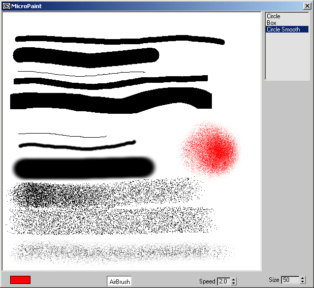

In this step of the Bitmap Painting tool development, we will add optional smooth falloff to the brush.
NATURAL LANGUAGE |
We will add a new item to the brushes listbox. |
We will extend the paintbrush function with a new case calculating the new color using the existing one and a falloff based on the pixel's distance to the center of the brush. |

We add a new brush to our "toolbox" - "Circle Smooth".
fn paintBrush pos = ( case BrushShape.selection of ( 1: ( if distance pos currentPos <= BrushSize.value/2 do setPixels theCanvasBitmap pos #(inkColor.color) ) 2: setPixels theCanvasBitmap pos #(inkColor.color) 3: (
When the "Circle Smooth" brush is selected,
theFactor =(distance pos currentPos)/ (BrushSize.value/2.0)
we calculate the distance from the pixel to be drawn to the center of the brush and divide by the radius of the brush.
if theFactor <= 1.0 do (
If the result is less than 1.0, the pixel lies inside the circle.
theFactor = sin ( 90.0 * theFactor)
In that case, we multiply the value by 90 and use the Sine function to calculate a nice falloff curve. Note that remarking this line gives you a linear falloff curve instead of the sine-based falloff curve.
thePixels = getPixels theCanvasBitmap pos 1
Next, we read a single pixel from the position we are about to write to.
if thePixels[1] != undefined do (
If the single pixel in the array is a valid color,
thePixels[1] = (thePixels[1] * theFactor) + (inkColor.color * (1.0 - theFactor))
we blend the color of the background with the brush color based on the distance factor. If the factor is 0.5, the two colors will be blended 50-50%. If the factor is 1 (at the edge of the circle, the background color will be used 100% and the ink will be 0%.
setPixels theCanvasBitmap pos thePixels
Finally, we write the color back into the bitmap.
