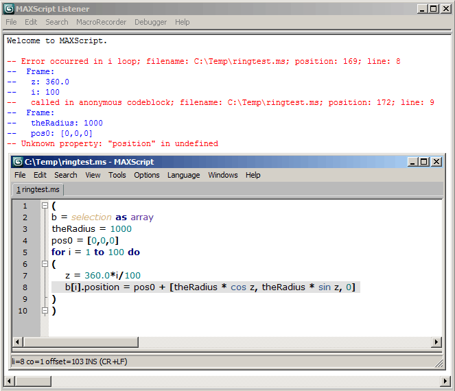

In the following figure, an Editor and a Listener window are shown where an error was detected while running the script.
The error occurred in the highlighted line in the Editor window.
Looking at the call stack trace-back, we see the error occurred when the for loop variable i is equal to 100.
In the line in error, the position of the object from array b with index i is being set.
After further investigation, it was found the array b only had 99 elements defined.
Thus element b[i] contained the value undefined , which resulted in the error as there is no position property associated with undefined .
ADVANCED INFORMATION ON THIS SPECIFIC ERROR: |
The correct way to avoid this particular error would be to use 'for i = 1 to b.count do' to ensure the loop never exceeds the number of objects in b, and also divide by b.count in the line 'z=360.0*i/b.count'. Obviously, the above "mistake" was introduced to cause an error for demonstration purposes. The script itself tries to place all selected objects in a circle with radius the Radius around the point pos0. |

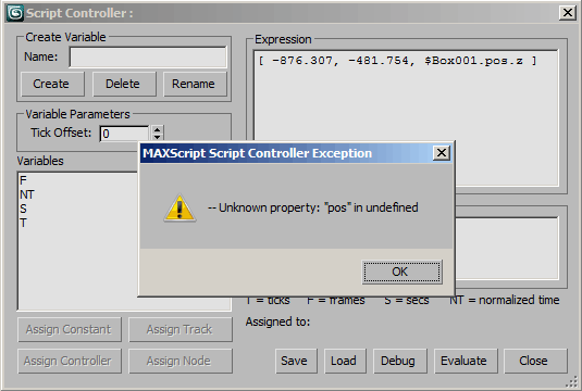

In the following figure, an error dialog and script controller dialog are shown.
An error was detected while running the script assigned to a script controller.
This error was caused by the deletion of object Box001, whose position was used directly in the script.

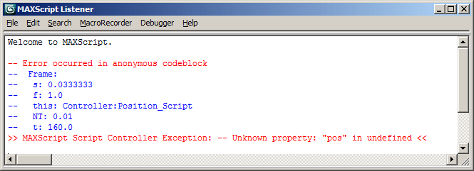

The MAXScript Listener shows the following call stack trace-back for this error:
Since 3ds Max 8, the above way of accessing object properties is considered obsolete and a Bad Practice exactly because it can cause a large number of errors when a referenced object is deleted or cannot be found for other reasons (for example when an object with a Script Controller is brought into a scene via XRef). The correct approach to avoid this specific kind of error would be to use a Variable assigned the Position track of Box001. Deleting the Box001 would not cause an error in the controller. As an added bonus, the controlled object would update its position when Box001 is moved along Z automatically. Please see Script Controllers for details. |
