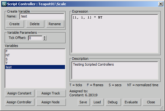

A script controller supports four types of user-defined variables: Constant, Target, Object, and Node. The main difference between these variables is the type of value or reference they contain, which in turn determines the type of notification messages that will cause an update of the script controller.
Note that in the Script Controller UI, the creation of the variable and the assignment of the value is performed in two separate steps (the Create button always creates a Constant Variable with a value of 0) while in MAXScript, the creation and assignment are performed in a single step.

<integer>NumVariables ()
Returns the number of variables defined in the controller.
A default controller with no user-defined variables already provides four pre-defined variables for time access:
1 - T, Current Time In Ticks, Constant
2 - S, Current Time In Seconds, Constant
3 - F, Current Time in Frames, Constant
4 - NT, Current Normalized Time, Constant
User-defined variables generally have an index higher than four.

EXAMPLE |
obj = Teapot()--Create a teapot -->$Teapot:Teapot001 @ [0.000000,0.000000,0.000000] obj.scale.controller = scale_script ()--Add a Scale Script Controller -->Controller:Scale_Script obj.scale.controller.numVariables ()--Default Variables Count -->4 obj.scale.controller.addConstant "test" (pi*2)--Add a Variable -->true obj.scale.controller.variableExists "test"--See if it exists -->true obj.scale.controller.variableExists "someValue" --This one does not -->false obj.scale.controller.GetType "test" --Check Variable Type -->#constant obj.scale.controller.numVariables ()--Check Variable Count -->5 obj.scale.controller.getIndex "test" --Get the variable's index -->5 obj.scale.controller.getName 5--Get the 5th variable's name -->"test" sliderTime = 1f--Set the current scene time to frame 1 -->1f obj.scale.controller.getValue 1--Time in Ticks -->160.0 obj.scale.controller.getValue"T"--Time in Ticksaccessed by Name -->160.0 obj.scale.controller.getValue 2--Time in Seconds -->0.0333333 obj.scale.controller.getValue"S"--Time in Secondsaccessed by Name -->0.0333333 obj.scale.controller.getValue 3--Time in Frames -->1.0 obj.scale.controller.getValue"F"--Time in Framesaccessed by Name -->1.0 obj.scale.controller.getValue 4--Normalized Time in Range 0-100 -->0.01 obj.scale.controller.getValue"NT"--Normalized Timeby Name -->0.01 obj.scale.controller.getValue 5--User Constant Variable -->6.28319 obj.scale.controller.getValue"test"--User Constant by Name -->6.28319 obj.scale.controller.getValue"sunPos"--User Constant by Name -- Runtime error: IScriptCtrl::GetVarValue - Bad Index or name: "sunPos" obj.scale.controller.renameVariable"test" "someValue"--Rename... -->true obj.scale.controller.getValue"someValue"--User Constant by New Name -->6.28319 |
The Time Offset can be applied to any variable and defines the time context in which the variable will be evaluated. The default offset is 0. In other words, the value of a variable can be the same or different than the time at which the controller is being evaluated.
