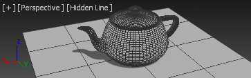

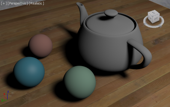

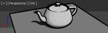

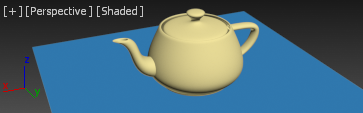

Visual Style group of controls

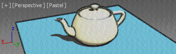

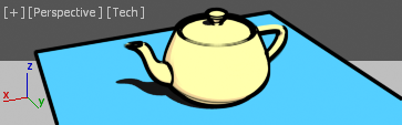

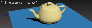

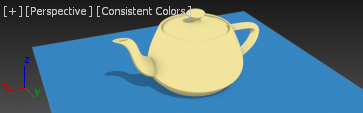

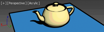

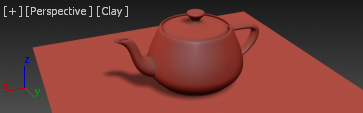

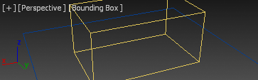

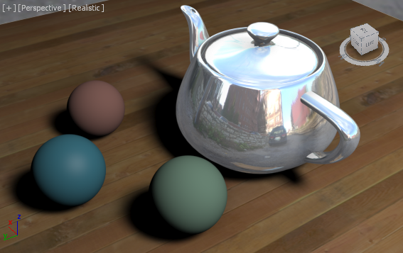

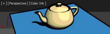

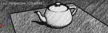

<ViewportViewSettingImpl>.VisualStyleMode : enum : Read|Write
VisualStyleMode enums: { #Realistic | #Shaded | #ConsistentColors | #HiddenLine | #Wireframe | #BoundingBox | #Clay | #Ink | #ColorInk | #Acrylic | #Tech | #Graphite | #ColorPencil | #Pastel }
Get/set the Viewport's Visual Style, including realistic, shaded and non-photorealistic modes. The property can be set as enum name or integer value. When getting, it will return the enum name.
Possible values are:
Numeric Value Enum Name
0 #Realistic
1 #Shaded
2 #Facets
Retired in 3ds Max 2013
3 #ConsistentColors
4 #HiddenLine
5 #Wireframe
6 #BoundingBox
7 #Ink
8 #ColorInk
9 #Acrylic
10 #Tech
11 #Graphite
12 #ColorPencil
13 #Pastel
14 #Clay

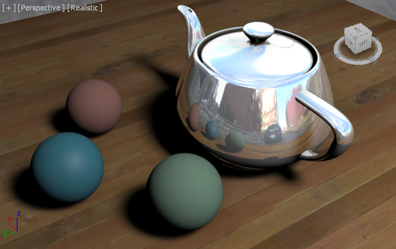

<ViewportViewSettingImpl>.ReflectionEnabled : bool : Read|Write
Get/set the state of the "Reflection From Environment" checkbox.
<ViewportViewSettingImpl>.DynamicReflectionEnabled : bool : Read|Write
Get/set the state of the dynamic reflections option (currently not exposed to the UI).
When set to True, Materials with a Raytrace or Reflect/Refract map in their Reflection map slot will calculate dynamic reflections of the surrounding scene objects if switched to "Show Realistic Material In Viewport" mode.
When set to False (default), no dynamic reflections will be calculated.
Reflection Properties Result Notes
.ReflectionEnabled=off
When .ReflectionEnabled is off, the state of .DynamicReflectionEnabled is ignored.
.ReflectionEnabled=on
.DynamicReflectionEnabled=off
When .ReflectionEnabled is on, Environment Reflection Maps are shown if the Material has a Reflection Map and Show Realistic Material In Viewport is on.
.DynamicReflectionEnabled=on
When both properties are on, both Environment Reflection Maps and Scene Objects will be reflected.
No reflections of reflections will be calculated though.
Reflections will look correct only on curved surfaces.

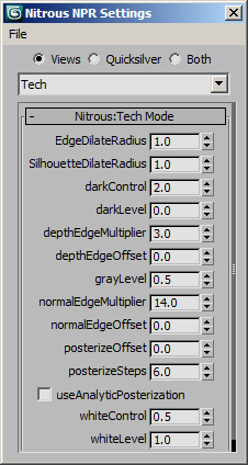

NPR Settings
Accessing NPR Parameters
<void><ViewportViewSettingImpl>.ShowNPRParameters()
Prints information about the NPR mode to the Listener including Parameter Name, Type, Value and Range. Returns OK.
<string by value><ViewportViewSettingImpl>.GetNPRParameterInfo()
Returns a string value containing information about the NPR mode including Parameter Name, Type, Value and Range. Similar to ShowNPRParameters() , but returns the info as a string value instead of printing to the Listener.
<integer><ViewportViewSettingImpl>.GetNPRParameterCount()
Returns the number of parameters in the current NPR mode.
<string by value><ViewportViewSettingImpl>.GetNPRParameterName <integer>index
Returns the name of the indexed parameter. The index is zero-based. If the index is out of range, the value of "No Parameter" is returned.
<enum><ViewportViewSettingImpl>.GetNPRParameterType <integer>index
GetNPRParameterType enums: { #Unknown | #Bool | #Int | #Float | #Float4 | #String }
Returns the type of the indexed parameter. The index is zero-based. If the index is out of range, the value of #Unknown is returned.

The following scripted dialog exposes all parameters of the current Viewport Style Mode (if any) in a dynamic rollout for interactive tweaking. It also supports the NPR settings of the Quicksilver renderer and allows you to set the viewport and the renderer at the same time, thus giving an instant preview of the Quicksilver settings in the active viewport:
SCRIPT:
macroScript NPRExplorer category:"MXS Help"
	global Nitrous_NPR_Rollout, Nitrous_NPR_SubRollout
	global Nitrous_NPR_Settings = NitrousGraphicsManager.GetActiveViewportSetting()
	try(destroyDialog Nitrous_NPR_Rollout)catch()
	local theINIfile = (getDir #plugcfg + "\\Nitrous_NPR_Settings.ini")
	rcmenu Nitrous_NPR_Menu
		subMenu "File"
			menuItem mnu_savePreset "SAVE Current Mode To Preset File..."
			menuItem mnu_loadPreset "LOAD Current Mode From Preset File..."
		on mnu_savePreset picked do Nitrous_NPR_Rollout.savePreset()
		on mnu_loadPreset picked do Nitrous_NPR_Rollout.loadPreset()
	rollout Nitrous_NPR_Rollout "Nitrous NPR Settings"
		radiobuttons rad_SystemToAffect labels:#("Views","Quicksilver","Both")
		dropdownlist ddl_NPRMode items:#("Realistic", "Shaded", "ConsistentColors", "Wireframe", "BoundingBox", "Ink", "ColorInk", "Acrylic", "Tech", "Graphite", "ColorPencil", "Pastel", "Clay")  height:15
		subRollout sub_rollout width:200 height:320
		fn createSubRollout source:1 =
			try(removeSubRollout sub_rollout Nitrous_NPR_SubRollout)catch()
			Nitrous_NPR_Settings = case source of
				default: NitrousGraphicsManager.GetActiveViewportSetting()
				2: renderers.current
			currentMode = case source of
				default: Nitrous_NPR_Settings.VisualStyleMode
				2: Nitrous_NPR_Settings.VisualStyle
			local theString = "rollout Nitrous_NPR_SubRollout \"Nitrous:"+currentMode as string +" Mode\" width:200 (\n"
			local paramCount = Nitrous_NPR_Settings.GetNPRParameterCount()
			if paramCount == 0 do theString += "label lbl_1 \"The Current Shading Mode\"\n label lbl_2 \"Exposes No Parameters!\"\n"
			for p = 0 to paramCount-1 do
				theName = Nitrous_NPR_Settings.GetNPRParameterName p
				case (Nitrous_NPR_Settings.GetNPRParameterType p) of
					#int: (
							theRange= (Nitrous_NPR_Settings.GetNPRMinInt theName) as string + ", " + (Nitrous_NPR_Settings.GetNPRMaxInt theName) as string +", "+ (Nitrous_NPR_Settings.GetNPRInt theName) as string
							theString += "spinner spn_"+p as string + " \""+ theName + "\" type:#integer range:["+theRange+"] fieldwidth:50\n"
							theString += "on spn_"+p as string + " changed val do (::Nitrous_NPR_Settings.SetNPRInt \""+theName as string+"\" val; ::Nitrous_NPR_Rollout.updateRenderer())\n"
					#float: (
							theRange = (Nitrous_NPR_Settings.GetNPRMinFloat theName) as string + ", " + (Nitrous_NPR_Settings.GetNPRMaxFloat theName) as string +", "+ (Nitrous_NPR_Settings.GetNPRFloat theName) as string
							theString += "spinner spn_"+p as string + " \""+ theName + "\" type:#float range:["+theRange+"] fieldwidth:50\n"
							theString += "on spn_"+p as string + " changed val do (::Nitrous_NPR_Settings.SetNPRFloat \""+theName as string+"\" val; ::Nitrous_NPR_Rollout.updateRenderer()) \n"
					#float4: (
							theString += "colorpicker clr_"+p as string + " \""+ theName + "\" alpha:true align:#right color:["+(Nitrous_NPR_Settings.GetNPRFloat4 theName) as string+"] fieldwidth:50\n"
							theString += "on clr_"+p as string + " changed val do (::Nitrous_NPR_Settings.SetNPRFloat4 \""+theName as string+"\" (val as Point4); ::Nitrous_NPR_Rollout.updateRenderer())\n"
					#bool: (
							theString += "checkbox chk_"+p as string + " \""+ theName + "\" checked:"+(Nitrous_NPR_Settings.GetNPRBool theName) as string +"\n"
							theString += "on chk_"+p as string + " changed val do (::Nitrous_NPR_Settings.SetNPRBool \""+theName as string+"\" val; ::Nitrous_NPR_Rollout.updateRenderer())\n"
					#string: (
							theString += "edittext edt_"+p as string + " \""+ theName + "\" text:\""+(Nitrous_NPR_Settings.GetNPRString theName) +"\" \n"
							theString += "on edt_"+p as string + " entered val do (::Nitrous_NPR_Settings.SetNPRString \""+theName as string+"\" val; ::Nitrous_NPR_Rollout.updateRenderer())\n"
				)--end case
			)--end p loop
			theString += ")"
			execute theString
			addSubRollout sub_rollout Nitrous_NPR_SubRollout
		)--end fn
		fn updateRenderer =
			if rad_SystemToAffect.state == 3 do
				renderers.current.VisualStyle = Nitrous_NPR_Settings.VisualStyleMode
					local theName = Nitrous_NPR_Settings.GetNPRParameterName p
						#int: (renderers.current.SetNPRInt theName (Nitrous_NPR_Settings.GetNPRInt theName))
						#float: (renderers.current.SetNPRFloat theName (Nitrous_NPR_Settings.GetNPRFloat theName))
						#float4: (renderers.current.SetNPRFloat4 theName (Nitrous_NPR_Settings.GetNPRFloat4 theName))
						#bool: (renderers.current.SetNPRBool theName (Nitrous_NPR_Settings.GetNPRBool theName))
						#string: (renderers.current.SetNPRString theName (Nitrous_NPR_Settings.GetNPRString theName))
					)--end case
				)--end p loop
		fn savePreset =
			local theStyle = Nitrous_NPR_Settings.VisualStyleMode
			if paramCount > 0 then
				local theFile = getSaveFileName caption:("Save "+ theStyle as string +" Settings As...") types:"Nitrous NPR Presets (*.NPR)|*.NPR"
				if theFile != undefined do
						local theFN = case (Nitrous_NPR_Settings.GetNPRParameterType p) of
							#int: Nitrous_NPR_Settings.GetNPRInt
							#float: Nitrous_NPR_Settings.GetNPRFloat
							#float4: Nitrous_NPR_Settings.GetNPRFloat4
							#bool: Nitrous_NPR_Settings.GetNPRBool
							#string: Nitrous_NPR_Settings.GetNPRString
						setIniSetting theFile (theStyle as string) (theName as string) ((theFN theName) as string)
					)--end p loop
			)--end if
		fn loadPreset =
				local theFile = getOpenFileName caption:("Load "+ theStyle as string +" Settings From...") types:"Nitrous NPR Presets (*.NPR)|*.NPR"
						local theType = Nitrous_NPR_Settings.GetNPRParameterType p
						local theFN = case theType of
							#int: Nitrous_NPR_Settings.SetNPRInt
							#float: Nitrous_NPR_Settings.SetNPRFloat
							#float4: Nitrous_NPR_Settings.SetNPRFloat4
							#bool: Nitrous_NPR_Settings.SetNPRBool
							#string: Nitrous_NPR_Settings.SetNPRString
						local theVal = getIniSetting theFile (theStyle as string) (theName as string)
						if theVal != "" do
							if theType != #string do theVal = execute theVal
							theFN theName theVal
					)--end p loop
					createSubRollout source:rad_SystemToAffect.state
					updateRenderer()
				)--end if
			)--end if
		fn updateList =
			local theMode = case rad_SystemToAffect.state of
			ddl_NPRMode.selection = findItem (for i in ddl_NPRMode.items collect i as name) theMode
		on rad_SystemToAffect changed state do
			local result = true
			local theClass = classof renderers.current
			if state > 1 and theClass != Quicksilver_Hardware_Renderer do
				result = querybox ("The current renderer is ["+theClass as string+"].\nClicking YES will replace it with Quicksilver.\n\nAre you sure you want to continue?") title:"Assign Quicksilver"
				if result then
					renderers.current = Quicksilver_Hardware_Renderer()
			if result then
				createSubRollout source:state
				if state == 3 do updateRenderer()
				updateList()
			else
				rad_SystemToAffect.state = 1
		on ddl_NPRMode selected itm do
				default: Nitrous_NPR_Settings.VisualStyleMode =  ddl_NPRMode.selected as name
				2: Nitrous_NPR_Settings.VisualStyle =  ddl_NPRMode.selected as name
			if rad_SystemToAffect.state == 3 do updateRenderer()
		on Nitrous_NPR_Rollout open do
			createSubRollout()
			updateList()
		on Nitrous_NPR_Rollout moved pos do
			setIniSetting theINIfile "Dialog" "Position" (pos as string)
	local thePos = execute (getIniSetting theINIfile "Dialog" "Position")
	if thePos == OK do thePos = [100,100]
	createDialog Nitrous_NPR_Rollout 220 380 thePos.x thePos.y menu:Nitrous_NPR_Menu
