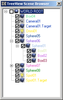

newNode.checked = not c.isHidden
The checked state of the node will be the inverse of the .isHidden property (which is true when the node is hidden). Since we want to check the box when the node is NOT hidden, we tell exactly this...
newNode.forecolor = color c.wirecolor.b c.wirecolor.g c.wirecolor.r
Since we have complete control over the color of each node in the TreeView, why not grab the color of the wireframe display and assign to the .forecolor property? This gives us a colorful reference to the color of the scene objects!

addChildren tv newNode c.children ) ) fn fillInTreeView tv = ( theRoot = tv.Nodes.add() theRoot.image = 1
We already defined the first image of the ImageListCtrl to show a sphere icon. We will use it to represent the root node.
