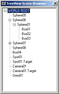

RESULT:

activeXControl tv "MSComctlLib.TreeCtrl" width:190 height:290 align:#center
Now we can create a TreeView ActiveX control in the rollout.

Finally, we create a new Dialog using the rollout definition.
