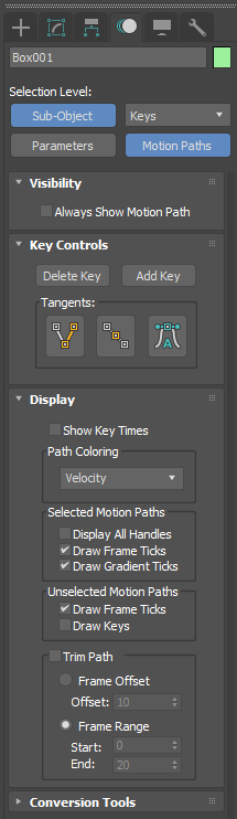

Motion Tab > Motion Paths
Properties:
maxOps.trajectoryMode : bool : Read|Write
When set to true , the Hierarchy tab of the Command Panel will be switched to Motion Paths mode.
When set to false , the Hierarchy tab of the Command Panel will be switched to Parameters mode.
If the Command Panel is not in the Hierarchy tab, it will be switched to it automatically.
Available in 3ds Max 2008 and higher.
maxOps.trajectoryKeySubMode : bool : Read|Write
When set to true , the Motion Paths mode will be switched to Key Sub-Object mode.
If the Hierarchy has not been set to Trajectories mode by setting maxops.trajectoryMode=true or by manually switching with the mouse , it will be set to Trajectories mode automatically.
maxOps.trajectoryAddKeyMode : bool : Read|Write
When set to true, the Add Key mode in the Trajectories rollout of the Hierarchy tab of the Command Panel will be turned on. When false, it will be turned off.
If the Trajectories mode is not in Key Sub-Object mode by setting maxops.trajectoryKeySubMode=true or by manually switching with the mouse, the Sub-Object mode will be set automatically.
maxOps.trajectoryPathGradation: enum : Read|Write
trajectoryPathGradation enums: {#speed|#wirecolor|#uicolor|#none}
Sets the gradation mode of the displayed motion paths. Available in 3ds Max 2018 and higher.
maxOps.selTrajectoryDrawFrameTicks: bool : Read|Write
When set to true, the frame ticks will be displayed along the selected motion paths. Available in 3ds Max 2018 and higher.
maxOps.unselTrajectoryDrawFrameTicks: bool : Read|Write
When set to true, the frame ticks will be displayed along the unselected motion paths. Available in 3ds Max 2018 and higher.
maxOps.unselTrajectoryDrawKeys: bool : Read|Write
When set to true, the keys will be displayed along the unselected motion paths. Available in 3ds Max 2018 and higher.
maxOps.trimTrajectories: bool : Read|Write
When set to true, trims the displayed motion paths. The motion paths are trimmed based on the value of fixedTrimRange. Available in 3ds Max 2018 and higher.
maxOps.fixedTrimRange: bool : Read|Write
When set to true, the motion paths are trimmed based on the frame range, and use the values stored in trimTrajectoriesStart, and trimTrajectoriesEnd. When set to false, the motion paths are trimmed based on the value stored in trimTrajectoriesOffset. Motion path trimming is enabled or disabled based on the value of trimTrajectories. Available in 3ds Max 2018 and higher.
maxOps.trimTrajectoriesOffset: integer : Read|Write
Defines the frame offset applied when trimTrajectories is on, and when fixedTrimRange is set to false. Available in 3ds Max 2018 and higher.
maxOps.trimTrajectoriesStart: integer : Read|Write
Defines the start of the frame range applied when trimTrajectories is on, and when fixedTrimRange is set to false. Available in 3ds Max 2018 and higher.
maxOps.trimTrajectoriesEnd: integer : Read|Write
Defines the end of the frame range applied when trimTrajectories is on, and when fixedTrimRange is set to false. Available in 3ds Max 2018 and higher.
maxOps.drawAllHandles: bool : Read|Write
When set to true, handles are drawn for knot control points along the motion path. Available in 3ds Max 2018 and higher.
maxOps.drawGradientTicks: bool : Read|Write
When set to true, gradient ticks are drawn along the motion path. Available in 3ds Max 2018 and higher.
maxOps.drawKeyTimes: bool : Read|Write
When set to true, key times are drawn at key points along the motion path. Available in 3ds Max 2019 and higher.
maxOps.selTrajectoryDrawKeys: bool : Read|Write
When set to true, control points for keys are drawn along the motion path. Available in 3ds Max 2019 and higher.
Methods:
<void>maxOps.deleteSelectedTrajectoryKey()
Deletes the selected trajectory key. Available in 3ds Max 2008 and higher.
<void>maxOps.breakSelectedKeyTangent()
Breaks the selected trajectory key's tangent handles. This allows the individual control of the two tangent handles. Available in 3ds Max 2018 and higher.
<void>maxOps.unifySelectedKeyTangent()
Unifies the selected trajectory key's tangent handles. This allows the movement of one handle to affect the relative position of the other handle. Available in 3ds Max 2018 and higher.
<void>maxOps.setSelectedKeyTangentToAuto()
Unifies the selected trajectory key's tangent handles, and ensures both tangent handle reside on the same line. Available in 3ds Max 2018 and higher.

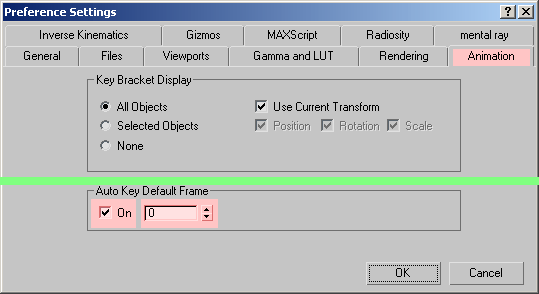

AutoKey Default Key
Properties:
maxOps.autoKeyDefaultKeyOn: boolean : Read|Write
When this option is set to true (default), creating a key in AutoKey mode on a frame other than the one specified by maxops.autoKeyDefaultKeyTime will create a key on the frame specified by maxops.autoKeyDefaultKeyTime with the initial value of the animated property. This is the default behavior of 3ds Max since its first release.
When this option is set to false , no key other than the one on the current frame will be created by the AutoKey feature.
See also preferences.autoKeyDefaultKeyOn for a System Global that exposes the same property.
maxOps.autoKeyDefaultKeyTime : time : Read|Write
When maxops.autoKeyDefaultOn is set to true , a key will be created automatically on the frame defined by this time value.
Available in 3ds Max 2017 and higher: The value can be set to any valid time value. In versions prior to 3ds Max 2017, the only possible values were 0f and 1f. See also preferences.autoKeyDefaultKeyTime for a System Global that exposes the same property as an integer value.
