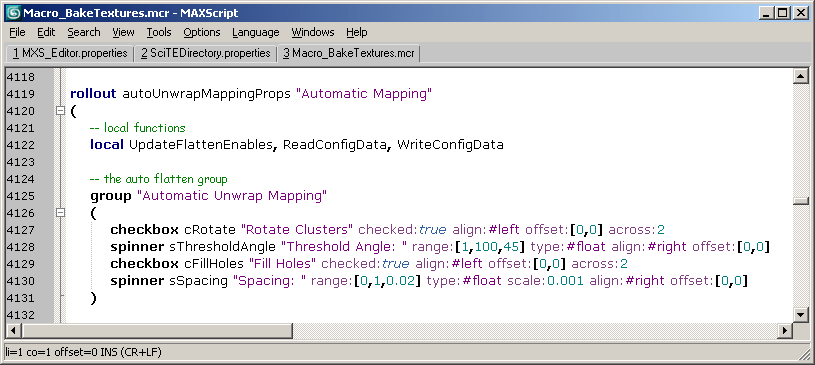

Here is the shipping \Ui\MacroScripts\Macro_BakeTextures.mcr file using the default color scheme:

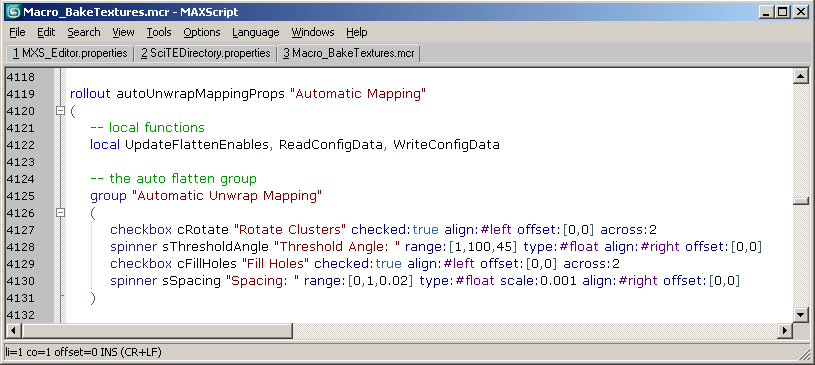

After saving a new "SciTEDirectory.properties" file containing the color definitions listed in the beginning of this topic to \Ui\MacroScripts\ and setting properties.directory.enable=1 in the file "MXS_Editor.properties", the same script looks like this:
Changing the property properties.directory.enable=0 and saving the "MXS_Editor.property" file to disk will instantly change the color coding back to the default color scheme in all currently opened tabs showing MAXScript files located in the \Ui\MacroScripts folder.
