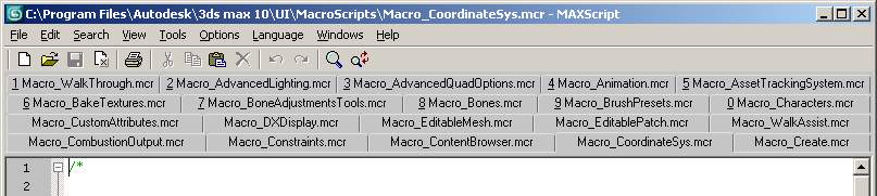

tabbar.visible (MAXScript default:1) tabbar.hide.one (MAXScript default :not set)
Setting tabbar.visible to 1 makes the tab bar visible at start up.
The buffers property must be set to a value greater than 1 for this option to work.
Setting tabbar.hide.one to 1 hides the tab bar until there is more than one tab.
tabbar.multiline (MAXScript default: not set)
Setting tabbar.multiline uses multiple lines for the tab bar, thus fitting more tabs on screen at the same time.

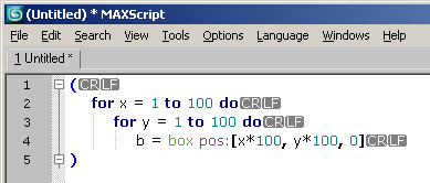

view.eol (MAXScript default: not set)
Setting this to 1 makes the Editor display the characters that make up line ends. This looks similar to [CR] , [LF] , or [CR] [LF] .
This is useful when using files created on another operating system with software that is picky about line ends.

indent.automatic (MAXScript default: 1) indent.opening (MAXScript default: 0) indent.closing (MAXScript default: 0) indent.maintain.<filepattern> (MAXScript default: not set)
Determines the look of automatic indentation.
Automatic indentation is turned on with indent.automatic=1 .
To indent a brace line after a compound statement start, set indent.opening=1 , likewise for the terminating brace.
FOR EXAMPLE, |
indent.automatic=0 indent.opening=0 |
With both set to 0, the result look like this: |
if i == 10 do ( print "Yes!" ) |
indent.automatic=1 indent.opening=1 |
With both set to 1, the result look like this: |
