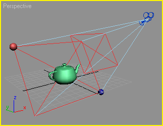

As you know, the camera has a cone (frustrum) with the top at the position of the camera. If the projection plane would "travel" along the Z axis of the camera, the farther it gets from the "eye", the larger it becomes in world units, but the number of pixels in the final image remains the same.
On the screenshot, you can see a camera and two projection planes (shown as red X). You can also see that the size of the projection plane is increasing as it gets farther from the camera.
The farther projection plane is exactly at the depth of the teapot's position in camera space.
The red sphere in the upper left corner of the projection plane corresponds to the screen_origin coordinate calculated above. To create the image, the screen_origin value was calculated, then the MAXScript line of code
sphere pos:(screen_origin*$Camera01.transform)
was called to create a sphere in world coordinates representing that point. ( screen_origin was originally in camera space, multiplying it by the camera's transformation matrix transforms it back into world coordinates!)
Same with the blue sphere - it represents the end_screen coordinate.
Here is what the camera sees when rendering the view - notice the red and blue spheres appearing exactly where expected:

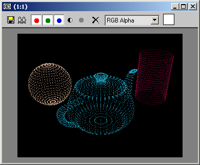

setPixels front_vfbscreen_coordsdot_color
Now we can draw a pixel in the front buffer at the location of the current vertex using the color array defined above using the wireframe color.
)--end v loop )--end o loop display front_vfb
When all vertices of all objects have been processed, we can update the display.
