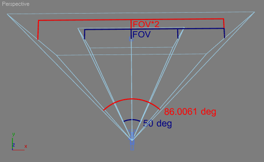

<fov_value>getViewFOV()
Returns the Field of View for the active viewport. If the viewport is an orthographic viewport, a value of 57.2958 degrees (1 radian) is returned.
<fov_value>viewport.GetFOV()
Returns the Field of View for the active viewport. Same as getViewFOV()
<boolean>viewport.SetFOV <float>
Sets the Field of View for the active viewport to the specified angle in degrees.
Works only with perspective and camera views.
Returns True if successful, False if the current viewport is not a perspective or camera view.
Available in 3ds Max 2008 and higher.

--while the perspective viewport is active, evaluate
viewport.setFOV 50.0 --set viewport Field Of View to 50 deg.
true
completeredraw() --redraw the views
OK
viewport.zoom 2.0 --zoom out two times
true
OK
viewport.getFOV() --get the new Field Of View
86.0061
What does this result mean?
The FOV angle is dependent on the width of the image plane, but the target distance remains the same.
When the angle is 50 degrees,tangens of half the angle is
tan (50.0/2) -> 0.466308
When you zoom in two times, the width increases twice.
Thus, atan(0.466308*2) -> 43.0031 (new half-angle) and
43.0031 * 2 =86.0062 which is the full viewport FOV angle:
