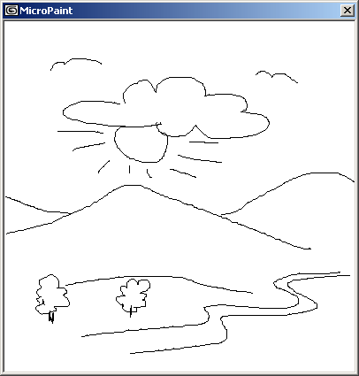

In this step of the Bitmap Painting tool development, we will add some better stroke drawing code to avoid the dotted appearance.
NATURAL LANGUAGE
We will extend the existing MacroScript by adding a new function.
The new function will be passed the old and the new position of the mouse and a line will be drawn between the two points to define a continuous stroke.

Result
