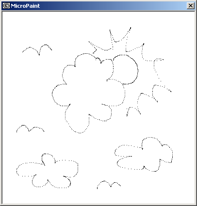

The user will paint by pressing the left mouse button and dragging the mouse inside the bitmap. |
The brush will be a single black dot - if the mouse moves fast, the strokes will appear dotted. |

) on MicroPaint_CanvasRollout lbuttonup pos do isDrawing = false
This dialog event handler is called whenever the left mouse button is released. We just lower the flag again so the drawing can be stopped.
on MicroPaint_CanvasRollout mousemove pos do if isDrawing do paintBrush pos
This dialog event handler is called whenever the mouse movies over the rollout, regardless of the button state. The argument pos contains the 2D position in pixels inside the rollout, coinciding with the position in pixels inside the bitmap (remember? Both have the same origin [0,0].
We check to see whether the left mouse button has been pressed but not released yet by looking into the isDrawing variable. If it contains true, we call the drawing paintbrush function with the current position of the mouse inside the dialog.
