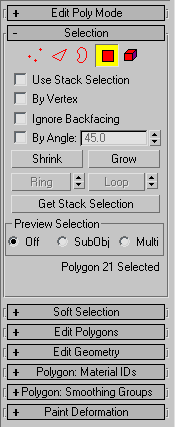

<Edit_Poly>.useStackSelection BooleanClass default: false -- boolean; Use_Stack_Selection
Get/Set the state of the Use Stack Selection checkbox in the Selection rollout. When checked, the incoming stack selection is used instead of the modifier's sub-object selection.
<Edit_Poly>.selectByVertex BooleanClass default: false-- boolean; Select_By_Vertex
<Edit_Poly>.ignoreBackfacing BooleanClass default: false -- boolean; Ignore_Backfacing
Get/Set the state of the Ignore Backfacing checkbox in the Selection rollout.
<Edit_Poly>.selectByAngle BooleanClass default: false -- boolean; Select_by_Angle
Get/Set the state of the Select By Angle checkbox in the Selection rollout.
<Edit_Poly>.selectAngle Float default: 45.0 -- angle; Selection_Angle
Get/Set the Select Angle value in the Selection rollout.

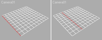

<Edit_Poly>.loopEdgeSel Integer default: 0 -- integer; Edge_Loop
Get/Set the Edge Loop value. Available in 3ds Max 8 and higher.
<Edit_Poly>.ringEdgeSel Integer default: 0 -- integer; Edge_Ring
Get/Set the Edge Ring value. Available in 3ds Max 8 and higher.
<Edit_Poly>.selectMode Integer default: 0 -- integer; Select_Mode
Get/Set the Edit Poly Selection Mode. Available in 3ds Max 2008 and higher.
Possible values are:
0 - Off
1 - Sub-Object
2 - Multi

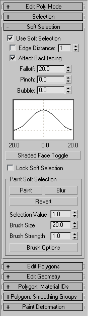

<Edit_Poly>.useSoftSel BooleanClass default: false-- boolean; Use_Soft_Selection
Get/Set the state of the "Use Soft Selection" checkbox in the Soft Selection rollout.
<Edit_Poly>.ssUseEdgeDist BooleanClass default: false-- boolean; Use_Edge_Distance
Get/Set the state of the Edge Distance checkbox in the Soft Selection rollout.
<Edit_Poly>.ssEdgeDist Integer default:1 -- integer; Edge_Distance
Get/Set the Edge Distance in the Soft Selection rollout.
<Edit_Poly>.affectBackfacing BooleanClass default: true-- boolean; Affect_Backfacing
Get/Set the Affect Backfacing checkbox state in the Soft Selection rollout.
<Edit_Poly>.falloff Float default: 20.0 -- animatable; world units
Get/Set the Falloff value in the Soft Selection rollout.
<Edit_Poly>.pinch Float default: 0.0 -- animatable; float
Get/Set the Pinch value in the Soft Selection rollout.
<Edit_Poly>.bubble Float default: 0.0 -- animatable; float
Get/Set the Bubble value in the Soft Selection rollout.
<Edit_Poly>.lockSoftSel BooleanClass default: false -- boolean; Lock_Soft_Selection
Get/Set the state of the Lock Soft Selection checkbox in the Soft Selection rollout. When enabled, the soft selection is not recalculated automatically and can be defined using the Paint Soft Selection tools.
<Edit_Poly>.paintSelValue Float default: 1.0 -- float; Selection_Value
Get/Set the Selection Value in the Paint Soft Selection group of controls in the Soft Selection rollout. Controls the selection value that is applied to the vertices by the paint brush.

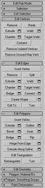

Related Methods:
To press the Extrude Along Spline button, see the #ExtrudeAlongSpline operation in EditPolyMod Interface - Operation Methods.
No properties related to this feature are exposed. To press the Remove button, see the #RemoveVertex and #RemoveEdge operations in EditPolyMod Interface - Operation Methods.
No properties related to this feature are exposed. To press the Break button, see the #BreakVertex operation in EditPolyMod Interface - Operation Methods.
No properties related to this feature are exposed. To press the Split button, see the #SplitEdges operation in EditPolyMod Interface - Operation Methods.
No properties related to this feature are exposed. To press the Flip button, see the #FlipFace and #FlipElement operations in EditPolyMod Interface - Operation Methods.
No properties related to this feature are exposed. To press the Insert Vertex button, see the #InsertVertexInEdge and #InsertVertexInFace operations in EditPolyMod Interface - Operation Methods.
No properties related to this feature are exposed. To press the RemoveIsolated Vertices / Remove Unused Map Verts buttons, see the #RemoveIsoVerts and #RemoveIsoMapVerts operations in EditPolyMod Interface - Operation Methods.

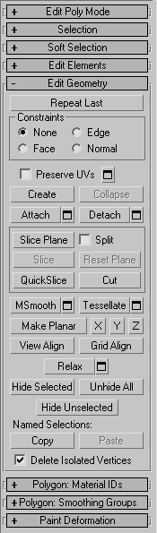

<Edit_Poly>.deleteIsolatedVerts BooleanClass default: true -- boolean; Delete_Isolated_Vertices
Get/Set the state of the Delete Isolated Vertices checkbox.
No properties related to this feature are exposed. To press the Collapse button, see the #CollapseVertex, #CollapseEdge , and #CollapseFace operations in EditPolyMod Interface - Operation Methods.
No properties related to this feature are exposed. To press the Hide/Unhide buttons, see the #HideVertex, #HideFace, #HideUnselectedVertex, #HideUnselectedFace, #UnhideAllVertex , and #UnhideAllFace operations in EditPolyMod Interface - Operation Methods.
No properties related to this feature are exposed. To press the Copy/Paste buttons, see the #NamedSelectionCopy and #NamedSelectionPaste operations in EditPolyMod Interface - Operation Methods.
No properties related to this feature are exposed. To press the Make Planar buttons, see the #MakePlanar, #MakePlanarInX, #MakePlanarInY , and #MakePlanarInZ operations in EditPolyMod Interface - Operation Methods.

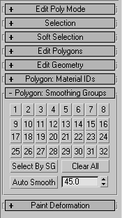

<Edit_Poly>.smoothingGroupsToSet Integer default: 0 -- integer; Smoothing_Groups_to_Set
Get/Set the smoothing group to set.
The value is a long integer where each of the 32 bits stands for a smoothing group to be set. The first bit is 2^0, the second is 2^1, and so on, and the last bit is 2^31. To calculate the integer to assign to this property, calculate the sum of all the bits to be set.
For example, to set bit 20, you can set the value to 2^(20-1) = 524288.
To set smoothing groups 1, 5, and 17, you need to add 2^(1-1) + 2^(5-1) + 2^(17-1) = 65553.
<Edit_Poly>.smoothingGroupsToClear Integer default: 0 -- integer; Smoothing_Groups_to_Clear
Get/Set the smoothing groups to clear. The value is a long integer where each of the 32 bits stands for a smoothing group to be cleared. See previous property for an example.
<Edit_Poly>.selectBySmoothingGroup Integer default: 0 -- integer; Select_By_Smoothing_Group
Get/Set the smoothing groups to select by.
<Edit_Poly>.selectBySmoothingGroupClear BooleanClass default: false -- boolean; Select_By_Smoothing_Group_Clear
Get/Set the Clear checkbox state in the Select By Smooth Group dialog. When set to true, the previous selection is cleared before new faces are selected.
<Edit_Poly>.autoSmoothThreshold Float default: 45.0 -- animatable; angle; Autosmooth_Threshold
Get/Set the auto-smoothing threshold angle. The angle between the normals of two neighbor faces are compared to the threshold. If below the threshold, the two faces are automatically assigned the same smoothing group, causing smooth shading across the common edge.
Methods:
<Edit_Poly>.SmGrp Floater()
Toggles the visibility of a Smoothing Groups floater version of this rollout.
Available in 3ds Max 2010 and higher.
<bool><Edit_Poly>.SmGrp FloaterVisible()
Related Methods:
See the #SelectBySmooth, #AutoSmooth and #SetSmooth operations in EditPolyMod Interface - Operation Methods.

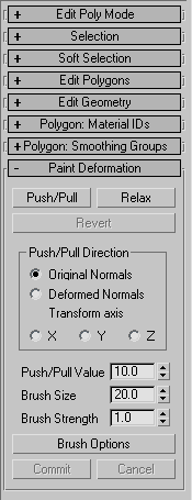

<Edit_Poly>.paintDeformAxis Integer default: 1 -- integer; Push_Pull_Direction
Get/Set the state of the Push/Pull Direction radio buttons in the Paint Deformation rollout.
1 -Original Normals
2 -Deformed Normals
3 -Transform Axis : X
4 -Transform Axis : Y
5 -Transform Axis : Z
<Edit_Poly>.paintDeformValue Float default: 10.0 -- float; Deformation_Value
Get/Set the Value applied by the Paint Deform brush.
<Edit_Poly>.paintDeformSize Floatdefault: 10.0 -- world units; Deformation_Size
Get/Set the Size of the Paint Deform brush.
<Edit_Poly>.paintDeformStrength Float default: 1.0 -- float; Deformation_Strength
Get/Set the Strength of the Paint Deform brush.

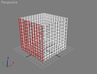

--Create a box with 10x10x10 segments:
b = box width:100 length:100 height:100 heightsegs:10 widthsegs:10 lengthsegs:10
ep = Edit_Poly()--create an Edit_Poly modifier
addModifier b ep--add the Edit_Poly modifier to the box
max modify mode--switch to Modify tab of Command panel
modPanel.setCurrentObject ep--set the Edit_Poly as the current level
subObjectLevel = 3--switch to Border level
--Now print the selection level using stand-alone interface access:
format"Selection Level Is: %\n"(EditPolyMod.GetEPolySelLevel ep)
--Now print the Mesh selection level using interface access via the modifier:
format"Mesh Selection Level Is: %\n"(ep.EditPolyMod.GetMeshSelLevel())
subObjectLevel = 4--switch to Face level
--Select a whole side of the box- last 100 polygons. Call the method
--without explicitly specifying the EditPolyMod interface - still works:
ep.Select #Face #{501..600}
ep.convertSelection #Face #Edge--convert the face selection to edge selection
subObjectLevel = 2--switch to edge mode to see the result
OUTPUT: |
$Box:Box01 @ [0.000000,0.000000,0.000000] Edit_Poly:Edit Poly OK OK OK 3 Selection Level Is: #Border OK Mesh Selection Level Is: #edge OK 4 true 220 2 ![]() |

<void>RingSelect <integer>RingValue <bool>MoveOnly <bool>Add
Moves the Ring selection. Available in 3ds Max 8 and higher.
RingValue is the quantity of edges to shift.
If MoveOnly is true , the selected edges are moved.
If Addis true and MoveOnly is true , the newly selected edges are added to the current selection.
If MoveOnly is true and Add is false , the newly selected edges are removed from the current selection.

MoveOnly |
Add |
Result: |
true |
false |
true |
false |
true |
true |
true |
true |
false |
true |
false |
true |
false |
false |
false |
false |

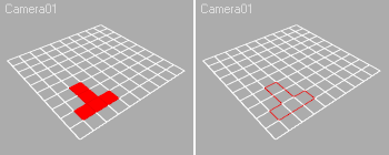

<integer>ConvertSelectionToBorder <enum>fromLevel <enum>toLevel
fromLevel enums:{#Object|#Vertex|#Edge|#Border|#Face|#Element|#CurrentLevel}
toLevel enums:{#Object|#Vertex|#Edge|#Border|#Face|#Element|#CurrentLevel}
Converts the current selection to border selection. The first argument represents the sub-object type to convert from, the second one represents the sub-object type to convert to.
EXAMPLE: |
p = plane width:100 length:100 widthsegs:10 lengthsegs:10--create a plane
addModifier p ep--add modifier to the plane
max modify mode--switch to modify mode
select p--select theplane
subObjectLevel = 4--switch to face SO level
editPolyMod.select ep #Face #{12,13,14,23,33}--select some faces
editPolyMod.ConvertSelectionToBorder ep #Face #Edge--convert to edge selection
subObjectLevel = 2--switch toedgeSO levelto see the result:
