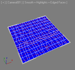

EXAMPLE
Random Connecting Within a 10x10 Grid using autoLoop passed as false:
--Step 1:
p = plane lengthsegs:10 widthsegs:10 wirecolor:blue --create a plane
convertTo p Editable_Poly --convert the plane to Editable_Poly
select p --select the plane to be able to see the results
max modify mode --switch Command Panel to Modify mode
subObjectLevel =2 --switch to polygon sub-object level
polyOp.setEdgeSelection p #{80,82,84,86,88} --select edges to define a ring
--Step 2:
PolyToolsModeling.RandomConnect 0.5 false --connect selected only
In this case, our initial selection already contains enough edges in a ring to create a valid random connection. We do not want the selected edge ring to be expanded further, so we pass false as the second argument, producing a random connection only within the existing selection.

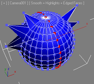

<bool>PolyToolsModeling.CenterLoop <bool>autoLoop
Centers edges or edgeloops on the edgerings they are on and places the vertices in the middle of the edges.
Select an edge or more edges and apply.
If the autoLoop argument is true , the selection will be automatically looped.

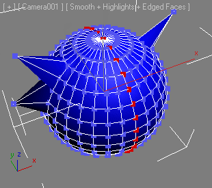

<bool>PolyToolsModeling.SpaceLoop <bool>autoLoop
Spaces the vertices evenly along the selected edges/edgeloops so that the distances between the vertices become equal.
If the autoLoop argument is true, the selection will be automatically looped.
If the SHIFT key is pressed while this method is being executed, it will also space loops on the top and bottom of a cylinder.

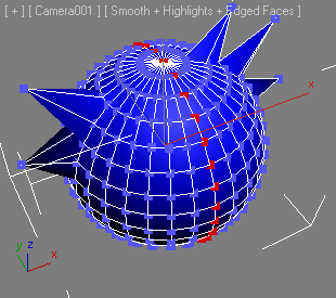

<bool>PolyToolsModeling.CurveLoop <bool>autoLoop <bool>spaceLoop
Adjusts each set of selected edges/edgeloops into smooth curves.
The curvature of each loop is determined by the position of the selected vertices along the loop. Think of the curve that you can create as a spline going from the endpoints of the edges/loop with a smoothly interpolated spline knot at each selected vertex.
If the autoLoop argument is true , the initial selection will be automatically looped before the tool is applied.
If the spaceLoop argument is true , all vertices will be evenly spaced along the loop.
If the spaceLoop argument is false , the initial relationship between vertices on the loop will be kept.
Note:
The edgeloop selection must not be closed (like a circle) for this tool to work because there needs to be a start and end-point for a curve.
The actual edgeloop can be closed, but not the selected edgeloop.

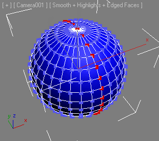

<bool>PolyToolsModeling.CircleLoop <bool>autoLoop
Turns each set of selected edges/edgeloops into the form of a circle.
The selected vertex along each loop determines the beginning point for the circle.
For open loops one of the "endpoints" of the edges/loop must be selected.
For closed loops (like around a cylinder), the vertex you want to least have change position must be selected.
If the SHIFT key is pressed while this method is being executed, it will also circle loops on the top and bottom of a cylinder.
Tip: Make sure that the vertex next after the first on the loop goes in the general direction of the intended circle so that the circle is not "inverted".

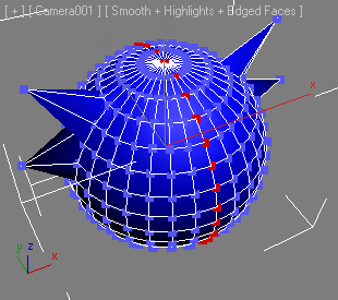

<bool>PolyToolsModeling.RelaxLoop <bool>autoLoop
Relaxes/smooths out the curvature of each set of selected edges/edgeloops.
Call multiple times to relax more.
If the autoLoop argument is true, checked the initial selection will be automatically looped before the tool is applied.

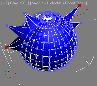

EXAMPLES
Using the Symmetry methods:
--Step 1:
s = sphere radius:12 segs:32 wirecolor:blue
convertTo s Editable_Poly
select s
max modify mode
subObjectLevel = 1
PolyToolsModeling.SymmetryGather s #x 0.01
--Step 2:
PolyOp.moveVert s #{122} [5,0,5]
--Step 3:
PolyToolsModeling.SymmetryPosToNeg #x
--Step 4:
PolyOp.moveVert s # {170} [-5,0,0]

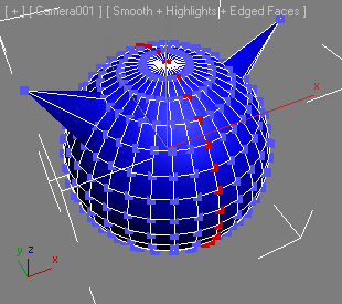

--Step 5:
PolyToolsModeling.SymmetryNegToPos #x
--Step 6:
PolyOp.moveVert s #{58} [3,0,5]

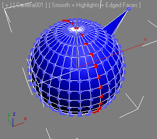

--Step 7:
PolyToolsModeling.SymmetryFlip #x
--Step 8:
PolyOp.setVertSelection s #{122,170}
PolyToolsModeling.SymmetryCopy()
PolyOp.moveVert s #{122,170} [5,0,-20]
--Step 9:
PolyToolsModeling.SymmetryPaste()
