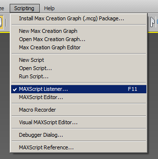

You can open the MAXScript Listener from the Scripting menu in the Main Menu: MainMenu > Scripting > MAXScript Listener.
Note that the default keyboard shortcut to the MAXScript Listener, F11 , is also listed next to the menu item. You can press F11 anytime to open the MAXScript Listener.

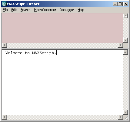

Click Open Listener.
The MAXScript Listener window appears with its Welcome message.

The MAXScript Listener window is an interactive interpreter for the MAXScript language and works similarly to a DOS command prompt window. You can enter MAXScript commands in this window and press the numeric ENTER key to execute them immediately.
For more details on the MAXScript Listener, see The MAXScript Listener Window topic.
