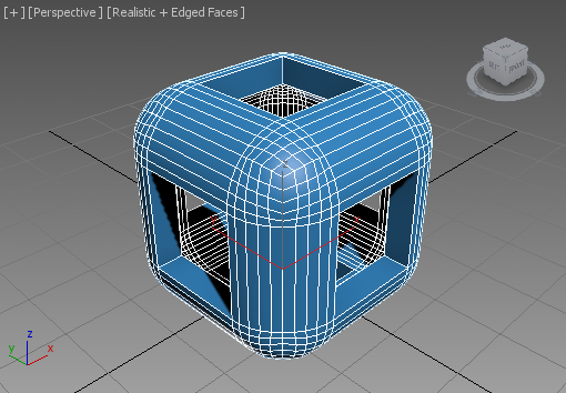

EXAMPLE |
b = box() --create a default Box c = chamfer() --create a Chamfer modifier addModifier b c --add the Chamfer to the Box c.amount = 5.0 --set the Amount to 5.0 c.segments = 5 --set the Segments to 5 c.tension = 0.5 --set the Tension to 0.5 to curve the new faces c.openChamfer = true --remove the new faces c.Invert = true --invert to remove the old faces instead s = shell() --create a Shell modifier s.outerAmount = 4.0 --set its Outer Amount (Thickness) to 4.0 addModifier b s --add the Shell modifier to the Box above the Chamfer modifier |
RESULT: |

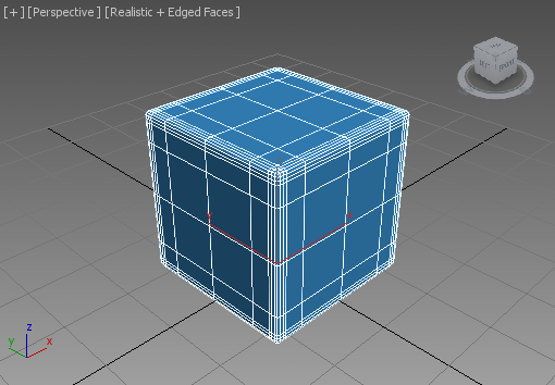

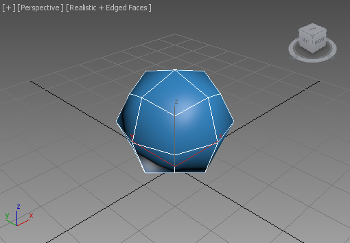

EXAMPLE |
b = box() --create a default Box c = chamfer() --create a Chamfer modifier addModifier b c --add the Chamfer to the Box c.amount = 2.0 --set the Amount to 2.0 c.segments = 2 --set the Segments to 2 c.tension = 0.0 --set the Tension to 0.0 to add new edges without changing the existing shape t = turboSmooth() --create a TurboSmooth modifier addModifier b t --add the TurboSmooth modifier to the Box --Try turning off the Chamfer modifier to see the difference (second image)... |
RESULTS: |
