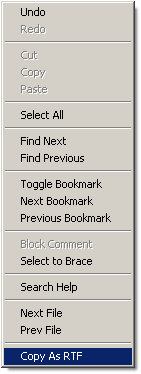

This is the default context menu which appears when you right-click in the Editor window:

Let’s assume you want to add a menu item for the editor feature "Copy As RTF". This feature is already listed in the Edit menu but could be placed closer to the mouse for easier copying of formatted colored text between the Editor and external word processing applications.
Let's first add a separator by placing two | delimiters and end the line with \ at the end of the user.context.menu definition in the MXS_Editor.properties file.
Then we locate in the List of Named IDs the ID called "IDM_COPYASRTF".
Let's add this command with label "Copy As RTF" to the context menu by adding to the user.context.menudefinition in the MXS_Editor.properties file. The final definition looks like this:
user.context.menu=\ Next File |IDM_PREVFILE|\ Prev File|IDM_NEXTFILE|\ ||\ Copy As RTF|IDM_COPYASRTF| |
Press CTRL+S to save the MXS_Editor.properties file.
Open a MAXScript file and select some lines.
Right-click in the Editor- the new separator and new menu item should appear!
Select the item "Copy As RTF" to copy the selected text to the clipboard including all formatting.
