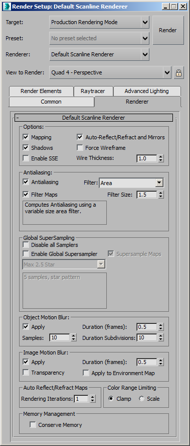

<Default_Scanline_Renderer>.mapping : boolean : Read|Write
Enable/Disable mapping.
<Default_Scanline_Renderer>.shadows : boolean : Read|Write
Enable/Disable shadows.
<Default_Scanline_Renderer>.enableSSE : boolean : Read|Write
Enable/Disable SSE.
<Default_Scanline_Renderer>.autoReflect : boolean : Read|Write
Enable/Disable automatic reflections and refractions.
<Default_Scanline_Renderer>.forceWireframe : boolean : Read|Write
Enable/Disable wireframe rendering.
<Default_Scanline_Renderer>.wireThickness : float : Read|Write
Get/Set the Wireframe Thickness.
<Default_Scanline_Renderer>.antiAliasing : boolean : Read|Write
Enable/Disable anti-aliasing.
<Default_Scanline_Renderer>.antiAliasFilter : maxObject : Read|Write|Validated by Validator function
Get/Set the Anti-Alias Filter.
<Default_Scanline_Renderer>.filterMaps : boolean : Read|Write
Enable/Disable map filtering.
<Default_Scanline_Renderer>.antiAliasFilterSize : float : Read|Write
Get/Set the Anti-Aliasing Filter Size.
EXAMPLE |
--Assign a Default Scanline Renderer to the production renderer renderers.production = Default_Scanline_Renderer () --> Default_Scanline_Renderer:Default_Scanline_Renderer -- Disable Anti-Aliasing in the production renderer renderers.production.AntiAliasing = false --> false |
<Default_Scanline_Renderer>.globalSamplerEnabled : boolean : Read|Write
Enable/Disable the Global Super-Sampler. Available in 3ds Max 6 and higher.
<Default_Scanline_Renderer>.globalSamplerClassByName : string : Read|Write
Get/Set the Global Super-Sampler by name. Available in 3ds Max 6 and higher.
<Default_Scanline_Renderer>.globalSamplerSampleMaps : boolean : Read|Write
Enable/Disable the global super-sampling of Maps. Available in 3ds Max 6 and higher.
<Default_Scanline_Renderer>.globalSamplerQuality : float : Read|Write
Get/Set the Global Super-Sampler quality. Available in 3ds Max 6 and higher.
<Default_Scanline_Renderer>.globalSamplerAdaptive : boolean : Read|Write
Enable/Disable Adaptive global super-sampling. Available in 3ds Max 6 and higher.
<Default_Scanline_Renderer>.globalSamplerAdaptiveThresh : float : Read|Write
Get/Set the Threshold for Adaptive global super-sampling. Available in 3ds Max 6 and higher.
<Default_Scanline_Renderer>.objectMotionBlur : boolean : Read|Write
Enable/Disable Object Motion Blur.
<Default_Scanline_Renderer>.objectBlurDuration : float : Read|Write
Get/Set the Object Motion Blur Duration.
<Default_Scanline_Renderer>.objectBlurSamples : integer : Read|Write
Get/Set the Object Motion Samples count.
<Default_Scanline_Renderer>.objectBlurSubdivisions : integer : Read|Write
Get/Set the Object Motion Blur Subdivisions.
<Default_Scanline_Renderer>.imageMotionBlur : boolean : Read|Write
Enable/Disable Image Motion Blur.
<Default_Scanline_Renderer>.imageBlurEnv : boolean : Read|Write
Enable/Disable "Apply to Environment Map".
<Default_Scanline_Renderer>.imageBlurTrans : boolean : Read|Write
Enable/Disable "Work with Transpacency".
<Default_Scanline_Renderer>.enablePixelSampler : boolean : Read|Write
Enable/Disable Global SuperSampling.
<Default_Scanline_Renderer>.imageBlurDuration : float : Read|Write
Get/Set the Image Motion Blur Duration.
<Default_Scanline_Renderer>.autoReflectLevels : integer : Read|Write
Get/Set the Automatic Reflection Rendering Iterations.
<Default_Scanline_Renderer>.colorClampType : integer : Read|Write
Get/Set the Color Clamping Type:
0 - Clamp
1 - Scale
<Default_Scanline_Renderer>.conserveMemory : boolean : Read|Write
Get/set the state of the "Conserve Memory" option.
