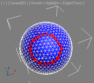

<bool>PolyToolsSelect.Loop <bool>cylinderEnds
Selects a loop based on the current sub-object selection:
Sub-Object Level |
ShiftPressed = False |
ShiftPressed = True |
Polygon |
Select sets of neighboring polygons and apply to select loops. |
Edge |
Select edges and apply to select loops. |
The tool can also perform loops on the top and bottom edges of a cylinder. Specifically designed for this purpose. |
Vertex |
Select sets of neighboring vertices and apply to select loops. |
The tool can also perform loops on the top and bottom vertices of a cylinder. Specifically designed for this purpose. |

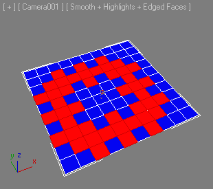

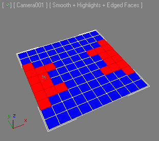

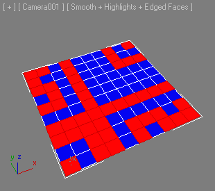

<bool>PolyToolsSelect.DotLoop <integer>value <bool>cylinderEnds <bool>opposite
Selects sub-object elements in a loop (or ring for edges) with gaps defined by the first argument.
Multiple dotted loops/rings can be performed at once.
In polygon and vertex sub-object level that requires the sets of initial selections to be not surrounded by any other selected elements.
Sub-Object Level |
ShiftPressed = FalseAltPressed = False |
ShiftPressed = TrueAltPressed = False |
AltPressed = True |
Polygon |
Select sets of two or more polygons in a row and apply to select polygon loops with gaps. |
Shift which polygons will act as the first in the loops. |
No effect. |
Edge |
Select edges and apply to select edge loops with gaps. |
Select edges and apply to select edge rings with gaps. |
The tool can also perform a loop on the top and bottom edges of a cylinder. |
Vertex |
Select sets of two or more vertices in a row and apply to select vertex loops with gaps. |
Shift which vertices will act as the first in the loops. |

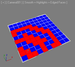

<bool>PolyToolsSelect.DotRing <integer>value
Selects sub-object elements in a ring with gaps defined by the argument.
Sub-Object Level |
AltPressed = True |
Polygon |
No effect |
Edge |
The tool will also be able to perform a loop on the top and bottom edges of a cylinder. |
Vertex |

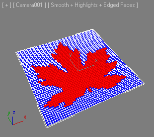

<bool>PolyToolsSelect.Fill ()
Fills the area between two selected sub-object elements. Note that this method will only work well if there is no extreme angle between the two selected sub-object elements.
Sub-Object Level |
Shift NotPressed |
ShiftPressed |
Polygon |
Select two polygons and apply to fill the area between them. The two polygons will become the lower and upper corner of the fill. The outer border of the area to fill needs to be quad polygons. |
Select two polygons and apply to fill a ring. The two polygons will become the lower and upper corner of the fill. The outer border of the area to fill needs to be quad polygons. |
Edge |
Not supported. |
Not supported. |
Vertex |
Select two vertices and apply to fill the area between them. The two vertices will become the lower and upper corner of the fill. The outer border of the area to fill needs to be clean loops. |
Select two vertices and apply to fill a ring. The two vertices will become the lower and upper corner of the fill. The outer border of the area to fill needs to be clean loops. |

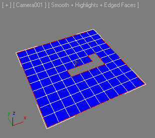

<bool>PolyToolsSelect.FillHole ()
Fills an enclosed area. Select one sub-object element within the hole and fill. The selected part must stand free from the surrounding selection, so as an example the selected polygon cannot have any selected polygons right next to it.
Sub-Object Level |
Function |
Polygon |
Select one polygon within the hole and fill. |
Edge |
Select one edge within the hole and fill. |
Vertex |
Select one vertex within the hole and fill. |

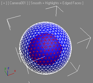

<bool>PolyToolsSelect.Similar <bool>edgeCount <bool>edgeLength <bool>faceCount <bool>faceArea<bool>topology <bool>normal
Selects sub-object elements which have similar properties as the selected elements. The five arguments define the rules to determine the similarity.
These rules vary depending on the current sub-object level:
Sub-Object Level |
Argument1 |
Argument2 |
Argument3 |
Argument4 |
Argument5 |
Polygon |
Edge Count Faces with the same number of sides as the selected faces. |
Face Areas Faces with roughly the same area/size as the selected faces. |
Topology Faces with the same surrounding edge topology as the selected faces. |
Normal Dir. Faces that share roughly the same normal direction. |
not used |
Edge |
Edge Lengths Edges with roughly the same length as the selected edges. |
Face Areas Edges with roughly the same combined face areas of the surrounding faces as the selected edges |
Topology Edges with the same surrounding face topology as the selected edges. |
Normal Dir. Edges that share roughly the same normal direction. |
not used |
Vertex |
Edge Count Vertices with the same number of edges going from them as the selected vertices. |
Edge Length Vertices with roughly the same combined edge length of the vertices edges as the selected vertices. |
Face Counts Vertices with the same number of surrounding faces as the selected vertices. |
Face Areas Vertices with roughly the same combined face area of the surrounding faces as the selected vertices. |
Normal Dir. Vertices that share roughly the same normal direction. |
Sub-Object Level |
Function |
Polygon |
Select polygon/polygons and apply to select all polygons which are similar based on the above rules. |
Edge |
Select edge/edges and apply to select all edges which are similar based on the above rules. |
Vertex |
Select vertex/vertices and apply to select all vertices which are similar based on the above rules. |

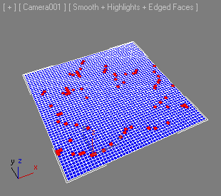

<bool>PolyToolsSelect.Random <float>percent <integer>number <integer>type <bool>withinSel
Selects random sub-object elements by percentage or absolute count.
The first argument is the percentage in the range of 0.0 to 100.0. It is used only when the third argument is set to 1.
The second argument is the absolute sub-object count to select. It is used only when the third argument is set to 0.
The third argument determines the selection mode: 0 = use absolute count and 1 = use percentage.
The fourth argument determines whether to select within all sub-objects or only the selected ones:
Sub-Object Level |
Polygon |
Select random polygons. |
Select random polygons only within the current selection. |
Edge |
Select random edges. |
Select random edges only within the current selection. |

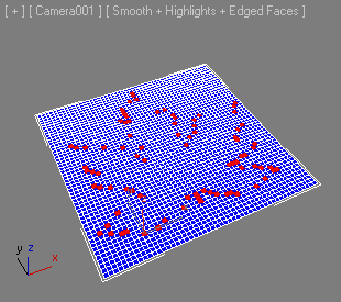

Vertex |
Select random vertices. |
Select random vertices only within the current selection. |
EXAMPLE: |
thePlane = Plane widthsegs:20 lengthsegs:20 --create a plane convertTo thePlane Editable_Poly --convert to EPoly select thePlane --select the plane max modify mode --switch to modify panel subObjectLevel = 4 --switch to Polygon level PolyToolsSelect.Random 0.0 20 0 false --select 20 randompolygons subObjectLevel = 2 --switch toEdgelevel PolyToolsSelect.Random 50.0 0 1 false --select50% of the edges |

<bool>PolyToolsSelect.NumericEdge <bool>withinSel
Selects edges that have only one adjacent polygon ("open edges").
The first argument controls whether only edges within the current edge selection must be tested (true) or whether all edges in the object must be used (false).
EXAMPLE: |
p = Plane widthsegs:10 lengthsegs:10 wirecolor:blue --create a plane
convertTo p Editable_Poly --convert to EPoly
select p --select the plane
PolyOp.deleteFaces p #{45..48,58} --delete some faces to add open edges
PolyToolsSelect.NumericEdge false --select open edges

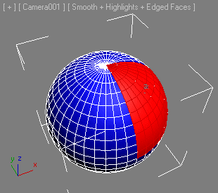

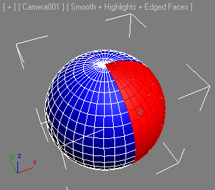

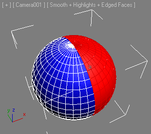

<bool>PolyToolsSelect.Half <integer>axis <bool>invert <bool>withinSel
Selects half of the sub-object elements at the current Sub-Object Level.
The first argument specifies the axis as follows:
1 - X
2 - Y
3 - Z
The second argument controls whether the positive side of the object (true) or the negative side of the object (false) will be selected.
The third argument controls whether to use the whole object (false) or only the current selection (true).
EXAMPLE: |
--Step 1: s = sphere radius:12 segs:40 wirecolor:blue convertTo s Editable_Poly --convert to EPoly select s --select the sphere max modify mode --switch to modify panel subObjectLevel = 4 --switch to facelevel --Step 2: Select positive (right) side along X using all faces PolyToolsSelect.Half 1 true false --Step 3: Select negative (front) side along Y using the existing selection PolyToolsSelect.Half 2 false true --Step 4:Select positive (top) side along Z using the existing selection PolyToolsSelect.Half 3 true true |

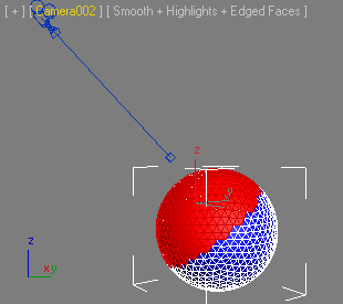

<bool>PolyToolsSelect.Normal <integer>axis <float>value <bool>invert
Selects sub-object elements in the current Sub-Object Level based on normal vector.
The first argument defines the reference world axis as follows:
1 - World X
2 - World Y
3 - World Z
The second argument defines the angle threshold. Sub-objects with normals that define an angle with the reference world axis that is less than the threshold will be selected.
The third argument defines whether to select the sub-objects whose normals are below the threshold (false) or the ones whose normals are above the threshold (true).
EXAMPLE: |
--Step 1: s = geosphere radius:12 segs:10 wirecolor:blue pos:[0,0,-5] convertTo s Editable_Poly --convert to EPoly select s--select the geosphere max modify mode --switch to modify panel subObjectLevel = 1 --switch to Vertex level PolyToolsSelect.Normal 3 15 false --select vertices within 15 degrees to +Z --Step2: subObjectLevel = 2 --switch to Edge level PolyToolsSelect.Normal 3 15 false --selectedgeswithin 15 degrees to +Z --Step3: subObjectLevel = 4 --switch to Face level PolyToolsSelect.Normal 3 15 false --select faces within 15 degrees to +Z --Step4: PolyToolsSelect.Normal 3 15 true --selectfaces outside of15 degrees to +Z |

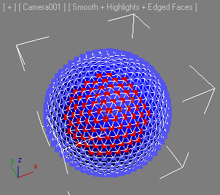

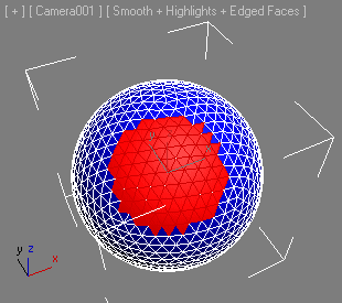

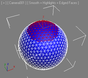

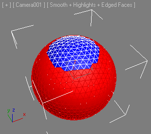

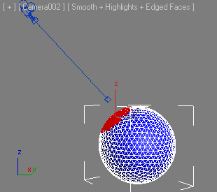

<bool>PolyToolsSelect.Perspective <float>value <bool>outline
Selects sub-object elements at the current Sub-Object Level whose normals are within the given threshold to the current view's Z axis.
The first argument defines the angle threshold.
The second argument controls whether all sub-objects within the Threshold must be selected (false) or only the ones adjacent to the outline of the selection (true).
EXAMPLE: |
--Step 1: s = geosphere radius:12 segs:10 wirecolor:blue convertTo s Editable_Poly --convert to EPoly select s --select the geosphere max modify mode --switch to modify panel subObjectLevel = 1 --switch to Vertex level PolyToolsSelect.Perspective 30 false --Step 2: PolyToolsSelect.Perspective 30 true |
--Step 3: subObjectLevel = 2 --switch to Edge level PolyToolsSelect.Perspective 30 false --Step 4: PolyToolsSelect.Perspective 30 true |
--Step 5: subObjectLevel = 4 --switch to Face level PolyToolsSelect.Perspective 30 false --Step 6: PolyToolsSelect.Perspective 30 true |

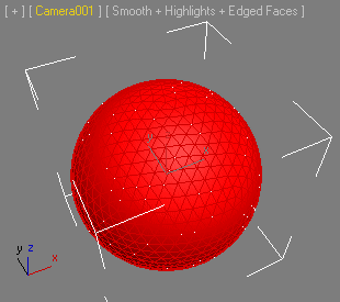

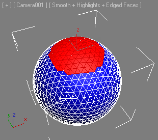

<bool>PolyToolsSelect.PerspectiveGrow <float>value
Grows the sub-selection in the current view space by assuming the closest sub-object element to the viewer's position as 0 and growing the selection away from the viewer in world units.
EXAMPLE: |
--Step 1: s = geosphere radius:12 segs:10 wirecolor:blue convertTo s Editable_Poly --convert to EPoly select s --select the geosphere max modify mode --switch to modify panel subObjectLevel = 4 --switch to Face level PolyToolsSelect.PerspectiveGrow 2 |
--Step 2: PolyToolsSelect.PerspectiveGrow 12 |
Because the Radius of the Geosphere is 12 units, selecting with a value of 12 selects approximately half of the sphere in the current view (Camera001 - left image). |

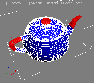

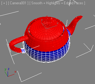

<bool>PolyToolsSelect.Distance <float>value
Selects sub-objects in the current level based on a percentage of the largest distance to the pivot point of the object.
The percentage is provided by the first argument.
Returns true on success, false on failure. For example, if not in a valid sub-object mode.
EXAMPLE: |
--Step 1: t = teapot radius:10 segs:10 wirecolor:blue convertTo t Editable_Poly --convert to EPoly select t --select the teapot max modify mode --switch to modify panel subObjectLevel = 4 --switch to Face level PolyToolsSelect.Distance 70.0 --and select using 70% --Step2: PolyToolsSelect.Distance 60.0 -- select using60% |
--Step 3: s.pivot = [0,0,5] --move pivot up by half the radius resetxform s --reset XForm collapseStack s --and collapse the stack subObjectLevel = 4 --switch toFacelevel PolyToolsSelect.Distance 70.0 --and select again using 70% --Step 4: PolyToolsSelect.Distance 60.0 |

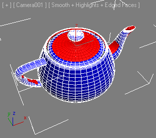

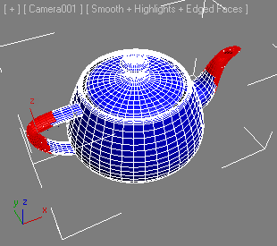

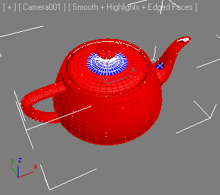

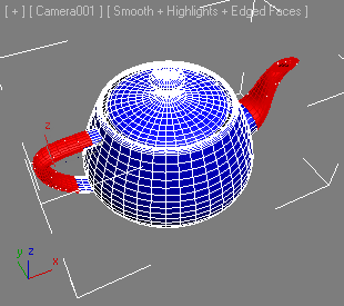

<bool>PolyToolsSelect.ConvexConcave <float>value <integer>isConcave
Selects sub-objects in the current Sub-Object Level based on a convexity/concavity threshold.
The first argument is the threshold value.
The second argument is the index of the Concave/Convex flyout in the UI as follows:
1 - Concave
2 - Convex
EXAMPLE: |
--Step 1: t = teapot radius:10 segs:10 wirecolor:blue convertTo t Editable_Poly --convert to EPoly select t --select theteapot max modify mode --switch to modify panel subObjectLevel = 4 --switch to Facelevel PolyToolsSelect.ConvexConcave 0.05 1 --Select Concave Faces --Step 2: PolyToolsSelect.ConvexConcave 0.001 2 --Select Convex Faces |

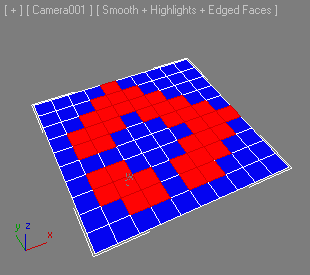

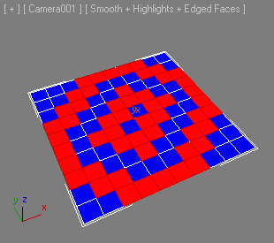

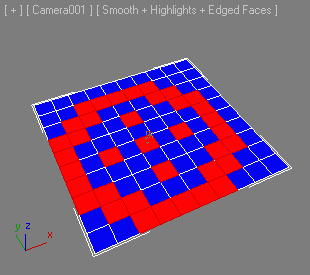

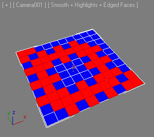

<bool>PolyToolsSelect.Pattern1 <integer>times
Applies Selection Pattern 1 for the specified number of times.
EXAMPLE: |
--Step 1:
PolyOp.SetFaceSelection p #{45} --select a central face
--Step 2:
PolyToolsSelect.Pattern1 1
--Step 3:
--Step 4:
--Step 5:
--Step 6:
Note that you can achieve the look seen on the above right screenshot by calling |
PolyToolsSelect.Pattern1 5 |
right after evaluating Step 1 to perform the iterations internally. |

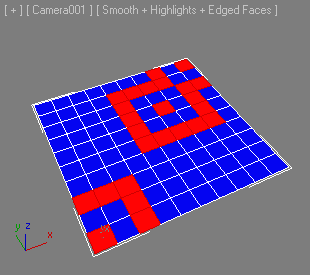

<bool>PolyToolsSelect.Pattern2 <integer>times
Applies Selection Pattern 2 for the specified number of times.
EXAMPLE: |
--Step 1:
--Step 2:
PolyToolsSelect.Pattern2 1
--Step 3:
--Step 4:
--Step 5:
--Step 6:

EXAMPLE: |
--Step 1:
--Step 2:
PolyToolsSelect.PatternDots 1
--Step 3:
--Step 4:
--Step 5:
--Step 6:
<bool>PolyToolsSelect.PatternChecker <integer>times
Applies Selection Pattern Checker for the specified number of times.
EXAMPLE: |
--Step 1:
--Step 2:
PolyToolsSelect.PatternChecker 1
--Step 3:
--Step 4:
--Step 5:
--Step 6:
<bool>PolyToolsSelect.PatternGrowLine <integer>times
Applies Selection Pattern Grow Line for the specified number of times.
EXAMPLE: |
--Step 1:
--Step 2:
PolyToolsSelect.PatternGrowLine 1
--Step 3:
--Step 4:
--Step 5:
--Step 6:
<bool>PolyToolsSelect.PatternOneRing <integer>times
Applies Selection Pattern One Ring for the specified number of times.
EXAMPLE: |
--Step 1:
--Step 2:
PolyToolsSelect.PatternOneRing 1
--Step 3:
--Step 4:
--Step 5:
--Step 6:

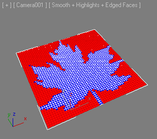

<bool>PolyToolsSelect.BitmapToSel <string>file <integer>mapchannel <point3>color
Selects sub-objects in the current Sub-Object Level based on a color from a bitmap file using a given mapping channel for the bitmap application.
The first argument is the file name of the bitmap.
The second argument is the mapping channel to use for the mapping of the bitmap onto the geometry.
The third argument is the color from the bitmap to use for selecting.
Internally, the color will be compared with a built-in threshold of +/- 8.0 (256/8= 32, so the threshold is 1/32 or about 3%).
EXAMPLE: |
--Step 1: p = Plane widthsegs:50 lengthsegs:50 wirecolor:blue --create a plane convertTo p Editable_Poly --convert to EPoly select p --select the plane max modify mode --switch to modify panel subObjectLevel = 4 --switch to Edge level --Select faces where the bitmap color is pure white. PolyToolsSelect.BitmapToSel "ELMLEAF.TGA" 1 white --Step 2: Select faces where color is black. PolyToolsSelect.BitmapToSel "ELMLEAF.TGA" 1 black |
--Step 3: PolyToolsSelect.BitmapToSel "ELMLEAF.TGA" 1 (white*0.97) --Step 4: PolyToolsSelect.BitmapToSel "ELMLEAF.TGA" 1 (white*0.96) |
--Step 3: PolyToolsSelect.BitmapToSel "ELMLEAF.TGA" 1 (white*0.04) --Step 4: PolyToolsSelect.BitmapToSel "ELMLEAF.TGA" 1 (white*0.03) |
