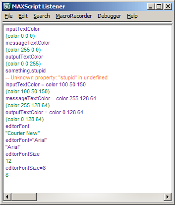

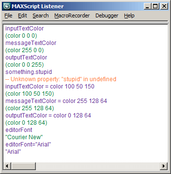

editorFont
Lets you get and set a String value that defines the font name for Legacy Script Editor windows and the MAXScript Listener.
Setting this variable effects all currently open and future Legacy Script Editor and MAXScript Listener windows.
This variable contains the corresponding value set in the MAXScript page of Customize > Preferences.
The Tabbed Script Editor introduced in 3ds Max 2008 has its own extensive formatting controls documented in the topic MAXScript Editor - Properties File Settings and is not affected by this value.
editorFontSize
Lets you get and set an Integer value defining the font point size for Legacy Script Editor windows and the MAXScript Listener.
Setting this variable effects all currently open and future script Editor and MAXScript Listener windows.

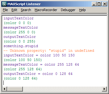

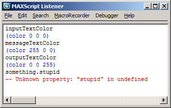

inputTextColor
Lets you get and set a Color value defining the color of typed input text in the MAXScript Listener.
messageTextColor
Lets you get and set a Color value defining the color of error message text in the MAXScript Listener.
outputTextColor
Lets you get and set a Color value defining the color of output text in the MAXScript Listener.
