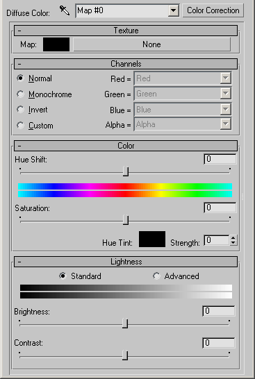

<Color_Correction>.color Color default: (color 0 0 0) -- fRGBA color; Color_1;
Get/set the map's color used when no input map has been specified.
<Color_Correction>.Map UndefinedClass default: undefined -- texturemap;
Get/set the input map to color-correct.
<Color_Correction>.rewireR Integer default: 0 -- integer;
Get/set the Red= drop-down list index.
Possible values are:
0 - Red
1 - Green
2 - Blue
3 - Alpha
<Color_Correction>.rewireG Integer default: 1 -- integer;
Get/set the Green= drop-down list index.
0 - Red
1 - Green
2 - Blue
3 - Alpha
<Color_Correction>.rewireB Integer default: 2 -- integer;
Get/set the Blue= drop-down list index.
0 - Red
1 - Green
2 - Blue
3 - Alpha
<Color_Correction>.rewireA Integer default: 3 -- integer;
Get/set the Alpha= drop-down list index.
0 - Red
1 - Green
2 - Blue
3 - Alpha
<Color_Correction>.rewireMode Integer default: 0 -- integer; Rewire_Mode
Get/set the Rewire Mode.
0 - Normal
1 - Monochrome
2 - Invert
3 - Custom
<Color_Correction>.hueShift Float default: 0.0 -- float;
Get/set the Hue Shift value.
<Color_Correction>.saturation Float default: 0.0 -- float;
Get/set the Saturation value.
<Color_Correction>.tint Color default: (color 0 0 0) -- fRGBA color; Hue_Tint;
Get/set the Hue Tint value.
<Color_Correction>.tintStrength Float default: 0.0 -- float; Hue_Strength;
Get/set the Hue Tint Strength value.

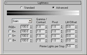

<Color_Correction>.lightnessMode Integer default: 0 -- integer;
Get/set the Lightness Mode.
Possible values are
0 - Standard
1 - Advanced
<Color_Correction>.brightness Float default: 0.0 -- float;
Get/set the Brighness value in Standard mode.
<Color_Correction>.contrast Float default: 0.0 -- float;
Get/set the Contrastvalue in Standard mode.
<Color_Correction>.exposureMode Integer default: 0 -- integer; Lightness;
Get/set theExposure Mode drop-down list's selection index.
0 - Gain
1 - F-Stops
2 - Printer Lights
<Color_Correction>.enableR BooleanClass default: false -- boolean;
Get/set the state of the R checkbox in Advanced Lightnessmode.
<Color_Correction>.enableG BooleanClass default: false -- boolean;
Get/set the state of theGcheckbox in Advanced Lightness mode.
<Color_Correction>.enableB BooleanClass default: false -- boolean;
Get/set the state of the B checkbox in Advanced Lightness mode.
<Color_Correction>.gainRGB Float default: 100.0 -- float; LightnessGainRGB;
Get/set the Gain RGB value in Advanced Lightnessmode.
<Color_Correction>.gainR Float default: 100.0 -- float; LightnessGainR;
Get/set the Gain R value in Advanced Lightness mode.
<Color_Correction>.gainG Float default: 100.0 -- float; LightnessGainG;
Get/set the Gain G value in Advanced Lightness mode.
<Color_Correction>.gainB Float default: 100.0 -- float; LightnessGainB;
Get/set the Gain B value in Advanced Lightness mode.
<Color_Correction>.gammaRGB Float default: 1.0 -- float; LightnessGammaRGB;
Get/set the Gamma RGB value in Advanced Lightnessmode.
<Color_Correction>.gammaR Float default: 1.0 -- float; LightnessGammaR;
Get/set the Gamma R value in Advanced Lightnessmode.
<Color_Correction>.gammaG Float default: 1.0 -- float; LightnessGammaG;
Get/set the Gamma G value in Advanced Lightnessmode.
<Color_Correction>.gammaB Float default: 1.0 -- float; LightnessGammaB;
Get/set the Gamma B value in Advanced Lightnessmode.
<Color_Correction>.pivotRGB Float default: 1.0 -- float; LightnessPivotRGB;
Get/set the Pivot RGB value in Advanced Lightnessmode.
<Color_Correction>.pivotR Float default: 1.0 -- float; LightnessPivotR;
Get/set the Pivot R value in Advanced Lightnessmode.
<Color_Correction>.pivotG Float default: 1.0 -- float; LightnessPivotG;
Get/set the Pivot G value in Advanced Lightnessmode.
<Color_Correction>.pivotB Float default: 1.0 -- float; LightnessPivotB;
Get/set the Pivot B value in Advanced Lightnessmode.
<Color_Correction>.liftRGB Float default: 0.0 -- float; LightnessLiftRGB;
Get/set the Lift/Offset RGB value in Advanced Lightnessmode.
<Color_Correction>.liftR Float default: 0.0 -- float; LightnessLiftR;
Get/set the Lift/Offset R value in Advanced Lightnessmode.
<Color_Correction>.liftG Float default: 0.0 -- float; LightnessLiftG;
Get/set the Lift/Offset G value in Advanced Lightnessmode.
<Color_Correction>.liftB Float default: 0.0 -- float; LightnessLiftB;
Get/set the Lift/Offset B value in Advanced Lightnessmode.
<Color_Correction>.printerLights Float default: 5.0 -- float; LightnessPrinter;
Get/set the "Printer Lights Per Stop" value in Advanced Lightness mode.
