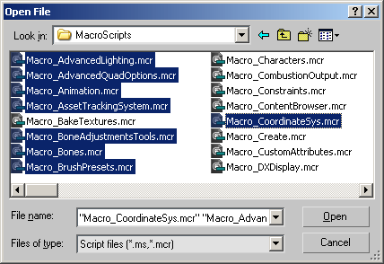

Open... (CTRL+O)- open one or more existing files.
While the main function of the MAXScript Editor is to edit MAXScript files (.ms, .mcr), it can be used to edit any text files.
The File Open dialog is a multi-file dialog and lets you select and load multiple files into multiple tabs at once.

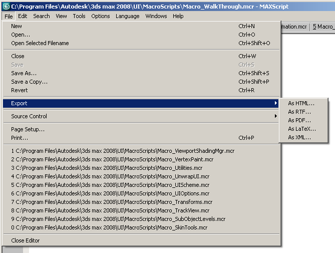

Export -shows a sub-menu with multiple export options. Each option opens an Export File As... dialog and exports to one of the following formats:
As HTML...
As RTF...
As PDF...
As LaTeX...
As XML...

List Of Recent Files-the MAXScript Editor will keep a list of recently edited files for easier access. The list of recent editor files is stored in the file MXS_SciTE.recent in the 3ds Max root directory. You can edit this list manually or even using MAXScript to add files to the recent files menu.
Close Editor- closes the Editor window. NOTE that this only HIDES the Editor but does not remove any opened files currently loaded in it. The Editor can be opened again for further editing of the opened or new files via the Main Menu > MAXScript > MAXScript Editor... menu option or any of the other options for creating new or editing existing files described in MAXScript Tabbed Editor Window. The same menu option can be used to toggle the editor on and off.
