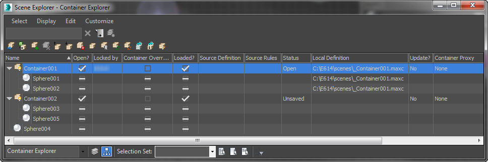

Container Explorer is a modeless dialog for viewing, sorting, and selecting containers and their contents. It provides all the functionality of the Scene Explorer, plus additional container-specific commands on the Container toolbar.
The Container Explorer displays a default set of column headings that provide information about containers in the scene and their contents, plus tools for editing container settings. For descriptions of the column headings, refer to Scene Explorer Columns.
