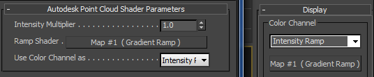

To enable point-cloud objects to respond to scene lighting:
- Apply an Arch & Design material to the object.
- Apply an Autodesk Point Cloud shader to the Arch & Design material's Diffuse Color Map input.
- Open the Autodesk Point Cloud shader settings in the Material Editor.
- If a shader is applied to the point-cloud object's color channel, such as when using the Elevation Ramp option, copy the shader from the Map button on the point-cloud object's Display rollout (command panel) to the Ramp Shader button on the Point Cloud Shader Parameters rollout in the Material Editor as an instance. An easy way to do this is simply by dragging and dropping from the command panel to the Material Editor. When the dialog opens querying Instance or Copy, make sure Instance is chosen and click OK.
The following illustration shows the result of doing this: Map #1 (Gradient Ramp) has been copied from the Display rollout on the right to the Ramp Shader parameter on the left.
- Also on the Point Cloud Shader Parameters rollout, set the Use Color Channel As parameter (drop-down list) to the active option on the command panel Display rollout; for instance, Intensity Ramp.
This gives the point-cloud object a look similar to that obtained with the default material, with the added benefit of enabling the object to respond to scene lighting. Note, however, that any shadows incorporated in the original capture remain.

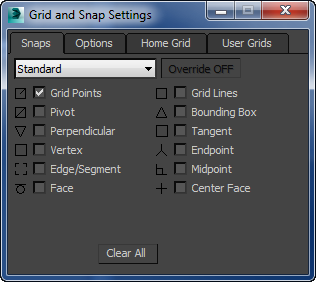

- On the main toolbar, click 3D Snap to turn on snapping, then right-click the same button to open the Grid And Snap Settings dialog.
By default, the dialog opens to the Snaps panel with the Standard category active and the Grid Points option enabled.
- Turn off Grid Points, then click Standard and choose Point Cloud Objects from the drop-down list.
- In the Point Cloud Objects category, turn on the single option: Point Cloud Vertex. Close the dialog.

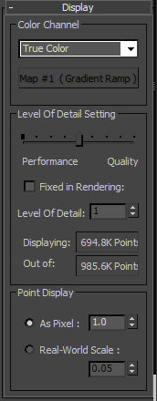

Display rollout
- Color Channel
- The method of coloring the point-cloud data in the viewports and in rendered output. Choose one of the following from the drop-down list:
- True Color Displays the original colors in the point-cloud file. Typically these colors are relatively faithful to those in the digitized scene. This is the default Color Channel setting.
- Elevation Ramp Applies a vertical color gradient derived from a
Gradient Ramp map to the point-cloud object. The leftmost point in the gradient corresponds to the bottom of the point-cloud object while the rightmost gradient point corresponds to the top of the point-cloud object.
To change the default grayscale gradient map, click the (Gradient Ramp) button below the drop-down list. This opens the Material/Map Browser, from which you can apply a different map, or choose the current map (under Scene Materials) to edit. You can apply any map, but only the Gradient Ramp map is meaningful in this context.
Tip: The Elevation Ramp option can be useful for visualizing relative heights of a scanned area for analysis. For example, you can apply a gradient to a terrain to see where water will drain (highest areas) and where it will accumulate (lowest areas). Using a highly differentiated gradient makes it easier to see these areas from the top.
Top view of a point cloud of a terrain, with elevation ramp showing the relative heights of different areas
Red is the lowest elevation and blue is the highest.
- Intensity Ramp Applies a texture derived from a Gradient Ramp map to the point-cloud object based on luminance values in the point cloud's original coloring. The leftmost point in the gradient corresponds to the darkest areas of the point-cloud object's original coloring while the rightmost gradient point corresponds to the brightest areas in the point-cloud object.
To change the default grayscale gradient map, click the (Gradient Ramp) button below the drop-down list. This opens the Material/Map Browser, where you can apply a different map, or choose the current map (under Scene Materials) to edit. You can apply any map, but only the Gradient Ramp map is meaningful in this context.
- Normal Ramp Applies coloring similar to that of a Normal Bump map to the point-cloud object. The coloring of each point depends on its normal direction.
- Single Color Applies a solid color to the point-cloud object. To change the color, click the color swatch below the drop-down list.
Level Of Detail Setting group
- Performance/Quality slider
- Controls the number of visible points in the cloud in the viewports. When Fixed In Rendering (see following) is off, this setting also affects the rendered output. To reduce the number of visible points and improve performance, move the slider toward the left (Performance) end of the scale. To increase the number of visible points, move the slider toward the right (Quality) end of the scale. For better-looking results at the potential cost of performance, use the right side of the scale.
The number of points currently visible and the total number of points in the object appear in the read-only fields at the bottom of the Level Of Detail Setting group: Displaying and Out Of, respectively.
Note: The available range of points depends on the viewpoint distance from the point-cloud object. Typically a wider range is available at greater distances, and moving the viewpoint closer reduces the range at the both ends. So the number of visible points at the Performance setting is lower when the viewpoint is relatively distant from the object, and higher when closer to the object.
The following illustration shows the results of using the extreme ends of the scale at different distances with a point-cloud object containing about 444,000 points.
Point cloud object viewed from far away (top) and close up (bottom):
1: Performance (13,600 points visible)
2: Quality (444,000 points visible)
3: Performance (161,000 points visible)
4: Quality (384,800 points visible)
- Fixed In Rendering
- When on, the Level Of Detail setting (see following) determines the visible number of points at render time. In this case, the Performance/Quality slider (see preceding) has no effect on rendered output.
- Level Of Detail
- Determines the number of points in the object visible in rendered output when Fixed In Rendering (see preceding) is on. The higher the value, the more points in the object are rendered. Range=1 to 100. Default=1.
- Point Display
- Choose how points in the cloud are displayed:
As Pixel Each visible point in the cloud is displayed as a single point of color, or pixel. The numeric setting serves as a multiplier for the pixel size. The greater the multiplier value, the larger the point.
Real-World Scale Shows and enables you to set the displayed point size in terms of the current Display Unit Scale setting.
The following illustration depicts a point-cloud model at the lowest Level Of Detail setting (Performance) with three different As Pixel values. Note that the lower As Pixel values permit seeing "through" the closest surface to the underlying surfaces.
1: As Pixel = 0.5
2: As Pixel = 1.0
3: As Pixel = 4.0
Tip: One way to get good performance with a solid-looking object is to use a relatively large Point Display setting with a low Level Of Detail setting.
