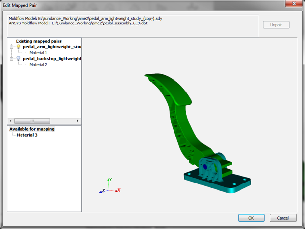

Edit an Assembly
After you have paired one or more parts in your structural assembly, you may need to edit the mapped pairs.
  1. Click (Home > Assembly > Edit). In the Edit Mapped Pair dialog, you will see all of the existing mapped pairs and any available bodies in the structural assembly that are still available for pairing. The active mapped pair in the display window is denoted by the lightbulb icon .
  2. To edit a mapped pair, select a pair and click Unpair.
  3. Click OK when you are finished editing the existing mapped pairs.
