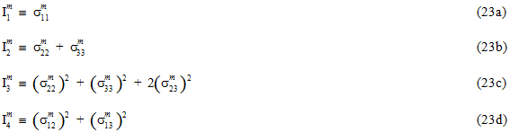

In Eq. 22, the quantities
(j = 1,2,3,4) are transversely isotropic invariants of the matrix average stress state.
The quantities
(i = 1,2,3,4,5) are the adjustable coefficients of the matrix failure criteria. In Eq. 22, if a superscript symbol '±' precedes an adjustable coefficient
, it indicates that the numerical value of
depends on whether the associated matrix average stresses are tensile or compressive; hence
represents two possible values. For the coefficient
, there are actually four possible values depending on whether
is positive or negative and also on whether
is positive or negative. Therefore, the matrix failure criterion (Eq. 22) contains a total of 10 adjustable coefficients that must be determined using measured strengths of the composite material.
