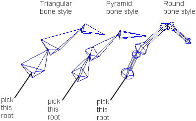

    Choose Animation > Tools > Bone Style to specify bone style.
    The following illustrations demonstrate the various bone styles.

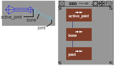

As you create each joint, a DAG node is added to the Scene Block Diagram (SBD) and a bone is drawn in the modeling windows connecting this joint to the previous joint.
Once it is drawn, you can copy and mirror the skeleton using Edit > Duplicate > Mirror , creating an inverse duplicate of the original.
You can also turn existing DAG nodes into joint nodes or make joint nodes into regular DAG nodes, by toggling their joint state in the skeleton editor (Animation > Editors > Skeletons ).
Each time you click in the modeling window when using New skeleton, you create a new joint node that is a child of the active joint node, and a bone is drawn between the two joints.
Each time you create a joint DAG node in this way, the pivot position of the joint DAG node is placed where you last clicked in the window. (You can also create a new joint DAG node by entering the pivot position on the keyboard.)
Create bones
Bones are drawn between joint nodes and their nearest ancestor joint node by connecting the rotation pivot points of the two nodes. You can change the shape of the bone (see Animation > Tools > Bone Style ) or turn off the display of the bones completely (see Animation > Show > Skeletons ).
The actual size of a 3D bone is defined by the distance between pivot points. The larger end of the bone shows the location of the rotation pivot point for the joint DAG node above the bone — the smaller end of the bone points to the rotation pivot point for the joint DAG node below the bone. Because the bone is defined by the pivot points, you can use Transform > Local > Set Pivot to change the length of a bone.

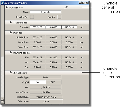

Find information on IK handles
  1. Select the IK handle.
  2. Choose Windows > Information > Information Window .
Name
The name of the IK handle. You can edit this field.
Bounding Box
Turns off the display of the IK handle’s bounding box.
Invisible
Turns off the display of the IK handle.
Translate
The handle’s translation coordinates. These are the only editable coordinates at this time because under Control type, TRANSLATION ONLY is chosen. The rotation and scale are not used to control the handle’s behavior.
Rotate Pivot
The handle’s rotation pivot coordinates.
Local Axes
The handle’s local axes coordinates.
Scale Pivot
The handle’s scaling pivot coordinates.
Bounding Box Min/Max/Size
The limits placed on the handles’s bounding box, which is made up of the Limb axis and Plane indicator.
Bounding Box Size
The size of the bounding box. Size = Max - Min.
Handle Type
The type of the IK handle: single, multi, or spline.
On/Off
Click these buttons to turn the IK handle on or off. When the handle is turned off, it is still visible but has no effect on the IK chain. To hide it completely, click Invisible at the top of the IK handle section.
root
The top-most joint in the skeleton hierarchy affected by the IK handle.
end-effector
The bottom-most joint in the skeleton hierarchy affected by the IK handle.

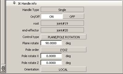

Control type

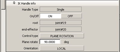

A single-chain IK handle has three levels of control accessed from the Control type pop-up menu.
  • TRANSLATION ONLY — this is the default control setting, suitable for most basic IK use. TRANSLATION ONLY means that you can only move or animate the IK handle’s translation channels.
  • PLANE ROTATION — this setting gives you more in-depth control of the IK handle. It lets you rotate the skeleton plane, the plane in which the joints contained in the IK handle lie (if all the joints of the IK handle do not lie in one plane, a “best” fit plane is chosen). When you choose this option, you can rotate the IK handle using the value in the Plane rotate box, letting you re-orient the plane indicator, and subsequently the skeleton plane, to create more complex motion in the chain.
  • You can also control the rotation of the plane axis by picking the IK handle and using the with the Rotate tool (Transform > Rotate ).
  • PLANE/POLE ROTATION — this setting provides advanced, specialized control of the IK handle with a new set of options. In some cases, the combination of translation and plane rotation might cause the IK solution to flip uncontrollably. Set the two Pole rotate box values to alter the plane of the skeleton, while keeping the pole in the same orientation relative to the skeleton plane.
  • Use the middle and right mouse buttons to rotate the IK solution’s Pole Axis and its projection.
The Pole order field is used to determine which two degrees of freedom are to be used to rotate the Pole Axis. In the earlier example illustrating plane rotation, the skeleton was drawn in the XY plane. Thus the Pole Axis is automatically positioned along the Z-axis (that is, perpendicular to the skeleton plane) when the IK handle is created, and the pole order is ZXY. This means that the Pole Axis is created parallel to the IK handle’s Z-axis (and thus given the blue Z-axis color), and its orientation is adjusted by applying a local X rotation, then a Y rotation, to the Pole Axis.

When to use plane rotation settings for IK handles
If the IK chain never needs to change orientation from its rest position, the default Translation Only setting will be all you need to animate the skeleton. For example, if the legs of a simple biped character in a walk cycle are oriented in a constant direction (that is, the knees always point forward), the IK handles for the legs will only need translation.
However, if that same biped character needs to have a “bow-legged” or “knock-kneed” appearance or if the character is dancing, you might want to rotate the skeleton plane of both legs to achieve this effect. In this case, choose the Plane Rotation setting for those handles in the Information Window, and adjust the Plane Rotate fields accordingly.

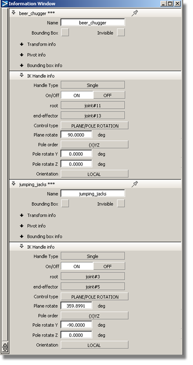

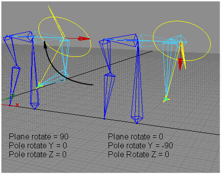

Complex single-chain example

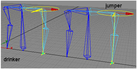

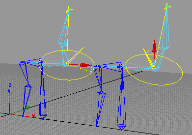

Below is an example of two torsos and how different types of arm movements are achieved through POLE/PLANE ROTATION.
In this example, the two torsos are identical and both have IK handles on the left arms. The default value for Plane rotate is 90 degrees. The default value for Pole rotate Y and Z is zero degrees. The left torso requires a drinking motion, while the right torso will perform a jumping motion.
  1. For the drinker, no pole rotation is required, so Pole rotate Y and Pole rotate Z are zero. Plane rotate is kept at 90 degrees.
  2. For the jumping torso, change the Plane rotate to zero, the Pole rotate Y to -90 and the Pole rotate Z to zero.
  3. With the IK handles picked, choose Transform > Move to drag the arms up to simulate a drinking motion.
  4. Open the Information window.
  5. Continue to move the arms up to create the jumping motion for the right torso. At some point, you’ll see the left arm “flip” a little, when the arm’s limb axis crosses over the Pole axis. The right arm doesn’t flip because the Pole Axis points forward, and therefore the arm’s limb axis never approaches it.

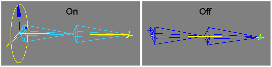

Turn IK handle display on or off
Use Animation > Show > IK Handles to turn the IK Handle display on or off.
Enable or disable IK handles
You can do the following:
When an IK handle is OFF, it behaves as if it does not exist. You can not select it. An individual IK handle can be turned ON or OFF from the Information window.
  1. Pick the IK handles (if you're using the Active option).
  2. Choose Animation > IK > IK Handles On/Off to set their states (ON or OFF according to the options' setup.)
