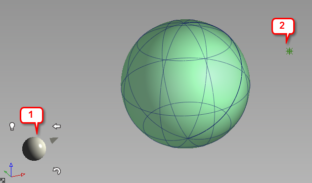

1: Light manipulator. 2: Light icon
Use the light manipulator
Click and drag the manipulator.
A point light icon represents the light in your model. Depending on the position of the camera with respect to the light, the light icon is not always visible. The light icon is toggled off by default.
