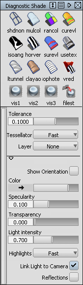

Adjust the options of a shading mode
- Click a shader icon to display its options at the bottom of the Diagnostic Shade window.
Tip:
When surfaces are partially transparent you can pick geometry “through” them. Open the options section of the Diagnostic Shade window and turn up the Transparency setting.
Set the shaded color
- Pick the surface or surfaces.
The options appear at the bottom of the Diagnostic Shade window.
- Click the color swatch to show to color editor.
How does setting the color in Multi Color mode affect objects?
- If you have picked objects, you will set the color of those objects. This only sets the color shown in this shading mode. It does not affect the rendered appearance (shader) of the objects.
- If nothing is picked, you will set the color of all objects, even objects to which you have already assigned custom colors. If you accidentally reset your colors, use Undo.
